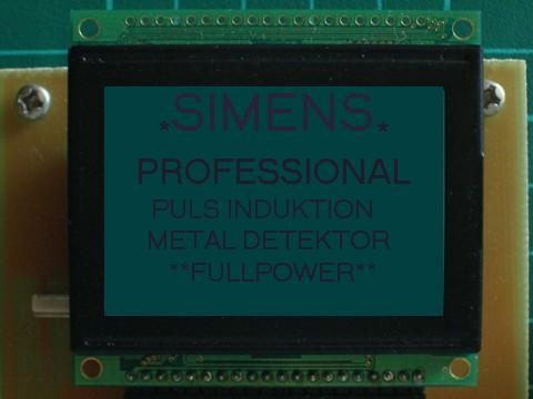

      I just posted this photo for an example of being careless. Siemens is a big Company , I never heard of Simens ????.....To spell wrong or not spell a name at all is very careless . Some People do not take manufacturing serious , or do not have pride in their workmanship............I am trying to rememember where this photo was on this Forum ???...My Pride of alzheimers ...........Take care all........Eugene

          • for Eugene
            hello
            This is a link to find a Simens detector .The picture was put in the forum by Aban whits lot of words but nothing real...Maybe just a a scam.
            SIMENS PI DETECTOR
            Enjoy
            Alex
            • Hi, some years ago I acquainted with a guy who had a PI with name Siemens (zimens accent) of course With a name on box. was obvious a neat homemade device. he was reluctant to see the LCD every time turned it on.
              I pretended to ignorance as only important thing for me all time is device capability and never deal with the firm name or reputation.
              only device capability and work range. we went for a test in one area, albeit was a good/acceptable PI but not better than our first PI, so gave up buying device or take him to our serious locations.
              But MDL is another thing eats all other PIs.

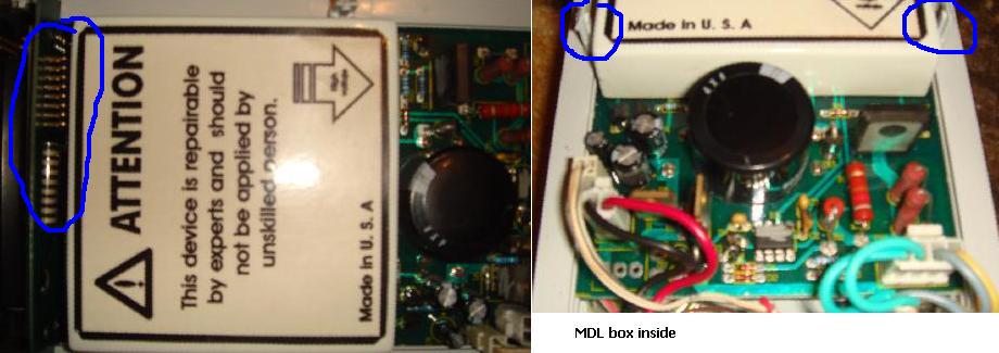

                Hello Michael , I forgot to tell you , that I did find a MDL 2000 "Log-search" Metal Detector , "CIRCA or year 1991" used for the Timber industry , and I am pretty sure , that is what your "Mystery P.I. Metal Detector" was originally used for . And it was 110/220 a.c.
                line powered and was mounted next to a log conveyer belt . This is my final "Observation / Interpretation / Calculation / .......And this is My Final Answer ,and it is used somewhere where logging is still a Very Big Business........"Canada" ????..................Have a Good Day !!!..........Eugene

                              • Real Metal Detectors
