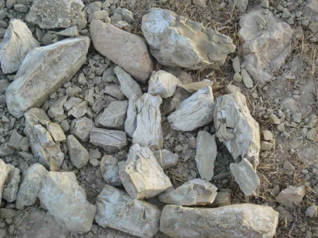

                Hi.
                our terrains are the worst soils there can never find sand, never, mostly mountainous, rocky places or hard soils which can hardly pick it. somewhere soil is like cement such the last place found by MDL, was very hard that at
                2 nigh working we could go down only 150 Cm. it needs hilty digger. where I've pointed to sandy places??!!!
                about pulse starII or even Lorenze, admittedly are somehow good detectors, but in comparison with MDL are highly weak and unstable with drifting or decreasing in signal intensity. theoretically is simple, yes with very high amplified output signal, but why other makers, producers have not
                made such thing by this time, if is simple?
                we've inserted our test target in such places and filled over it every other layer soil and big stones to make it very similar to a real buried treasure.
                our Luminous, Pulse star II and even Lorenze detect it hardly by force
                and when you go searching around and come back over test target place, occasionally detect it(drifting) but, MDL; either hit it very strongly and can go search around for hectares and come back, detects it as same first with same intensity.

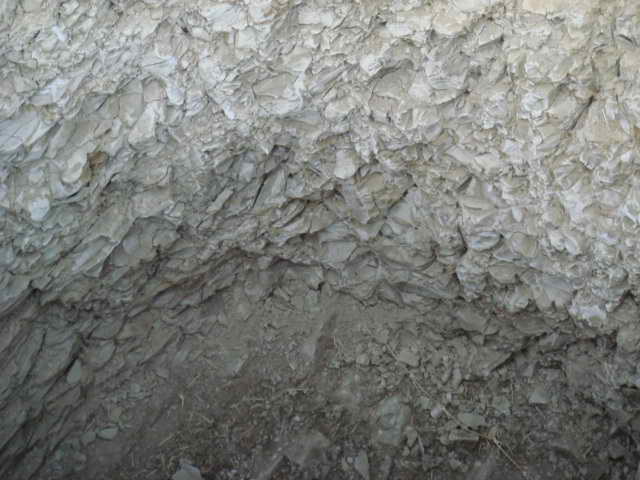

                      here you see our dug hole to 150 Cm. surely isn't sandy. caused bad blisters on our palms.

                              Hi Hung, no, it was more than one year ago at march.2007 and in another area. they went down up to 12 meters nothing found, yes, it was the first and the only noticeable signal with FG80 from 10-12 meters distance
                              with 1 meters signal width ( I thought lest be an ON TV buried in that remote wilderness area that signal after 10 times repeating gradually faded out.
                              at that time we didn't have MDL, although the place was entirely unworkable for any kind of MD or GPRs. the guys had a map of big treasury. it's about 7 months we own it and only for 2 latest month we are working intensively.
                              after that we never get any noticeable signal with FG80.
                              I scanned this latest place where I'm pointing with FG80 step by step at best weather conditions, and I remember I passed exactly over this point, but no signal, we regarded this place free of treasure. after nailing MDL we searched most of our places after getting no signal, I offered to search this area again with MDL, it held our hands and pulled to the location. If any treasure be excavated can conclude certainly FG80 is useless at least for very deep targets.
