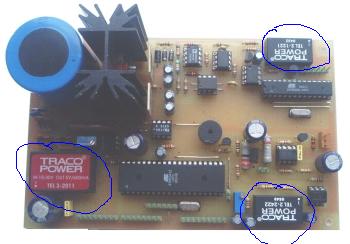

    1. Why are field tests of the models you can build not published ?
    2. Are field tests available from your commercial units ?
    3. I never see any prices on anything !!
    4. What is the truth on PIU modules. Hobby or Commercial Only ????
    5. How dependable are the Traco-Power modules . The 3 that I have circled are close to $100 u.s. dollars !!Are they dependable .
    6. Is your Market only in Europe ??
    7.The Honest difference between "Project Circuits" And the one's only that you can buy !!!
    I have heard of several Pulsedetector units being built and having very bad results. So please if the Owner or administrator of pulsedeteektor can answer the above questions with "HONESTY" and not go around in circles , this would be great !!!Sometimes the truth can carry a ton of hidden knowledge and wisdom. Polite and Courteous answers are Welcome........Thank-You ....Eugene

    Hi Eugene,
    I made the above unit some months ago.... and lost a lot of time and money...and at last I hammered it.
    I don't know why some people enjoy when others get pain....
    Thanks,

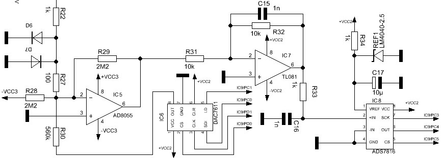

      Hi Eugene,
      what I have found on this site are lots of interesting circuits using AVR chips. Maybe, I can use some tricks for my own AVR PI project.
      But I would never use any
      - DC/DC converters (causing too much noise)
      - IGBT switching FET and IGBT driver for the TX stage (IGBT's are quite slow)
      - CNY17 (slow optocoupler) for the TX switching signal, but OK for the audio stage coupling
      - only one RX amplifier stage
      Maybe, the projects are not designed well. The internal A/D converter of the AVR chips can only sample up to 15 kSPS (max). This is quite unsufficent (10-12 bit resolution) for the PI front end and some stages should not be made in digital technique.
      Otherwise interesting site. But I wouldn't build the projects. The projects are giving not much performance which should persuade someone to buy the professional versions.
        I think that the bad Miner designing causes a lot of damage to the ADC. The IC7 output swings between (-3.5V) to +3.5V while the absolute maximum rated voltage for +input of ADS7816 is (-0.3V) to Vcc +0.3V...
        What do you think?
