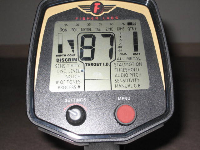

                  I have been hunting with a T2 for the past 8 months. I found the Fisher F-75 manual is more detailed instructions for using the T2. You can ignore any features in the F75 manual that are not found on the T2. But from personal experience, I can tell you how I use the T2.
                  First, you will get extra amplification if you set the discriminate level to over 45. So I usually set it for 50, then switch to all metal mode to hunt for all metals with higher amplification. I seldom use discriminate mode because it is easily fooled, and I can see what metals I am finding in the all metal mode by watching the screen.
                  I use the automatic ground balance most of the time. The ground I hunt is usually between 80 and 97 on the scale, and I readjust the level every few minutes. But when I get to black sand or damp ocean sand, I see the automatic level drop lower. When the auto ground balance sees soil lower than 40 it will stop making automatic settings. So you must manually set it.
                  In damp ocean sand, I often set it somewhere between 8 and 15, and I find the depth is much less than when in dry soil with settings of 80-97. I have used the T2 over ocean sand that was submerged in a 1 inch layer of water, which required me to set it to a level of 2 or 3, and I got a depth of maybe 2 inches to find a US quarter. Dry sand with a layer of black magnetic sand on it has a similar effect.
                  When hunting in heavily mineralized soils or salt water, I recommend using a PI detector or maybe a minelabs VLF designed for this, not the T2. The good thing about the T2 is that for good soils, it has been able to find silver and gold targets next to small iron trash. I see both targets on the screen. You will also see the all metal mode will show all targets on the screen so you know what you found even in all metal mode. The F75 is supposed to be an improved version of this, but I doubt the differences are worth the difference in price.
                  Here are the settings I usually use when I turn on the T2:
                  1. power on
                  2. Auto ground balance
                  3. switch to discriminate mode and set for
                  sensitivity=90
                  disc level = 50
                  tones = 2+
                  4. switch to all metal mode and set for
                  sensitivity = 90
                  hum level = +2
                  Then go hunting in the all metal mode and watch the screen to see if you want to dig a target.
                  You can always make adjustments to the levels if they don't suit you. I sometimes use the discriminate mode if I am finding a lot of trash, and I get tired of listening to constant beeping.
