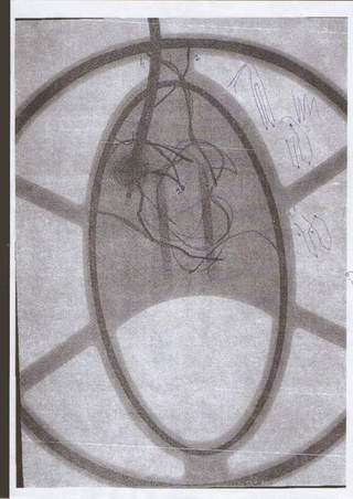

          Also i need to know if CZ 20 coil has any semiconductors inside the coil, because i bealive the problem with my CZ 20 could be on the coil.
          Next week i will try to pass the coil by an airport X ray machine to see whats inside
            Nelson
            I am pretty sure the CZ20 10.5 inch coil does not have a circuit board inside . Next you should check the resistance of the tx and rx windings.
            EugeneClick image for larger version
