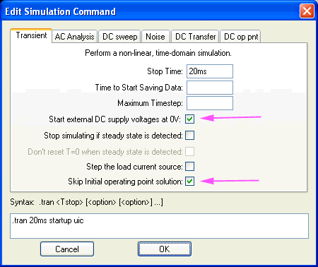

                Aziz, a friend send me some question by mail;
                "Skinuo sam simulacioni program SwitcherCAD III,probao da uradim simulaciju oscilatora za MRH detektor i nisam uspeo.Tačno meri jednosmerne napone ali AC vrednosti neće da simulira,AC napon na kalemu naprimer.Molim za pomoć.
                Unapred hvala"
                Meaning;
                I downloaded SwitcherCad III,tried to simulate MRH (Relic Hawk) oscillator without success. It is accurate in measuring DC voltages but AC values wont simulate, AC voltage at coil, fer instance!? Please help!
                Many thanks in advance
                This question is addressed to you Aziz. Friend do not manage English language well, so asked me to put this question here,for you.
                So i guess, it would be nice you to give some hints here, step by step, how to simulate oscillator part with coil connected..
                This is also interesting subject for others, me too, although i am not pretty tied to simulators, generally.

                  I've simulated RH oscillator in LTspice... and works. Maybe your friend need to set "startup" clause in the analisys params... otherwise no oscillations will appear.
                  In real world some noise make oscillations start in the circuit: you have to simulate a transient in spice too to get initial imbalance that will start oscillations... the trick is starting with raising voltage from 0, the transient will be enough to init the process.

                      Hi ivconic,
                      I had also problems in simulating oscillator circuits in the beginning. Until I found the following initial settings shown in the attachement. This will work in many cases. The checkbox on "Skip Initial operation point solution" should also be set. As Max mentioned, the "startup" option is also very important.
                      I will put an another oscillator here (I have it simulated already) for experiments. It is a Hartley-Oscillator. Remove the ".txt" extension and load into LTspice.

                        Like Aziz reported... when he will check the first checkbox , from top, the software will add the label "startup" as parameter ...
                        One could also add by hand... just right clicking at the analisys tag and adding that param, same stuff.
                        Once he will set it... the voltage will be supposed starting from 0 volts... thus giving enough imbalance to see oscillations appears. If one start spice considering a steady state initial condition is , instead, likely an ideal equilibrium is already enstablished there, and no perturbations: this prevent the system to oscillate and your friend will see only steady state e.g. voltages of an ideal system really far from reality of built circuits... where noise exist... and you switch on oscillator with voltage then raising from 0v to e.g. 8V for real.
