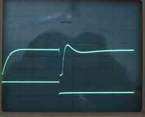

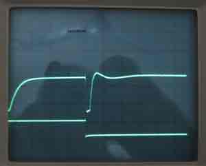

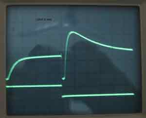

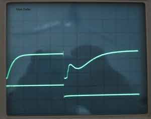

                      OK, here are the scope pictures. I will post them separately so the legend does not get mixed up.
                      Picture #1, NO TARGET

                        Picture # 2, Silver Dollar

                          Picture # 3
                          Steel nail.
                          You can see how the signal goes in opposite polarity than the silver dollar.

                            Picture # 4.
                            1/2" lead minie ball. This represents a target with lesser conductivity and minimal surface area versus mass.

                              Hi Tinkerer,
                              What does a piece of ferrite do to the curve?
                              What happens if you run a nail vertical across the coil and then horizontal?
                              Great work!
