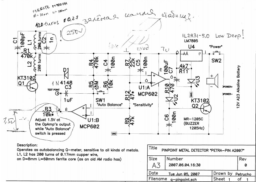

          • #65
            Is U4 drawn correctly in the schematic, with the coil input to - and the feedback loop to + ? It seems that pins 2 and 3 are reversed, at the very least?
            • #66
              ...Collapse signal of coil feed inverting input of U4

                    Originally posted by Gyur666 View Post
                    Does anybody have something experience about it?
                    Nobody know Petra-Pin pinpointer? I'm going to build it. I think it is a simple way to make a two sensitivity, usable pinpointer.
