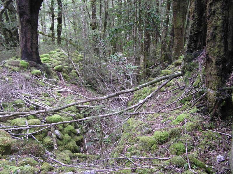

        My use for a non-motion (and non-groundbalacing, or should I use the word ground-compensating) PI Metal Detector is probably rather unique.
        What I’ve learnt over a number of years and after trying a number of different types of metal detectors here in New Zealand, is that a fully waterproof non-motion PI Metal Detector is the best type of Metal Detector to go after sizeable gold nuggets in some New Zealand goldfields. Which must seem ridiculous to any detectorists reading this who go for gold in the desert goldfields of Australia and North America . However, the best areas in New Zealand for large gold are in the highly vegetated areas with lots of scrub (primarily the West Coast of the South Island ) where the detector coil can’t be swung and must be slowly moved among the vegetation and as close to the ground as possible. Trying to use a conventional motion detector such as my Goldquest SS in these heavily vegetated areas is frustrating to say the least, with the signal coming and going, and it can produce spurious signals as the coil brushes against wet vegetation. Detectors such as my Goldquest SS are also much too sensitive with their low pulse delay and they don’t ignore the small pieces of rubbish that my Aquapulse, with its pulse delay of about 250, will ignore.
