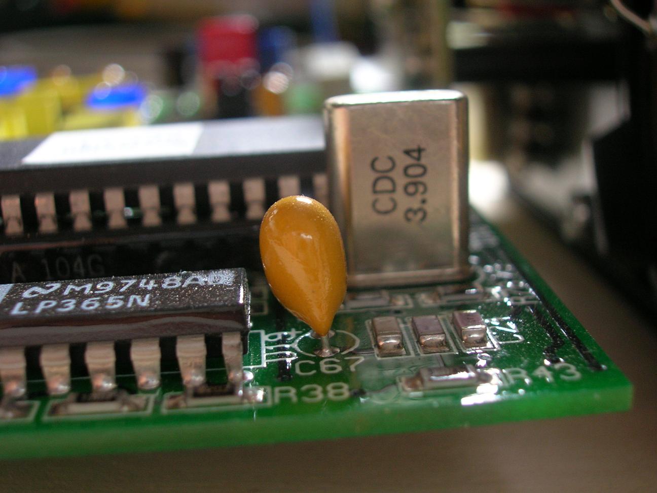

    Hi all.
    I own a ML sovereign that after a hard drop (2m high) is not working anymore.
    I suspect the problem to be the crystal, since this is the only fragile part while the cards are made in SMT and I don't see any wire broken.
    May this be correct? I haven't had time to check with oscilloscope if it is oscillating or not, but if that is the case, where can I get a 3.904 MHz quartz? I don't think it is a common frequency...

        Solved
        Well, just for everyone's information...
        I was lucky. The quartz wasn't faulty (otherwise I wouldn't have had no chance to fix it, because I didn't find it anywhere with that frequency).
        It was simply the main switch inside the volume potentiometre that, when turned on, short circuited the +bat to the ground.
        Thanks anyway.

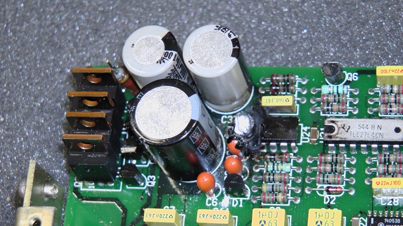

              Hi, I have faulty Minelab Sovereign early model Rev1.1.
              I can see that transistor Q7 is carbonaited. Can any one check for me what Q7 type is?
              I may replace U24 next to it as well . I think U24 is TE0620N but it could be T*062*N.
              One more is C32 I can only expect that it was 22uF16V like C31 next to it.
              If some one can confirm it, please.

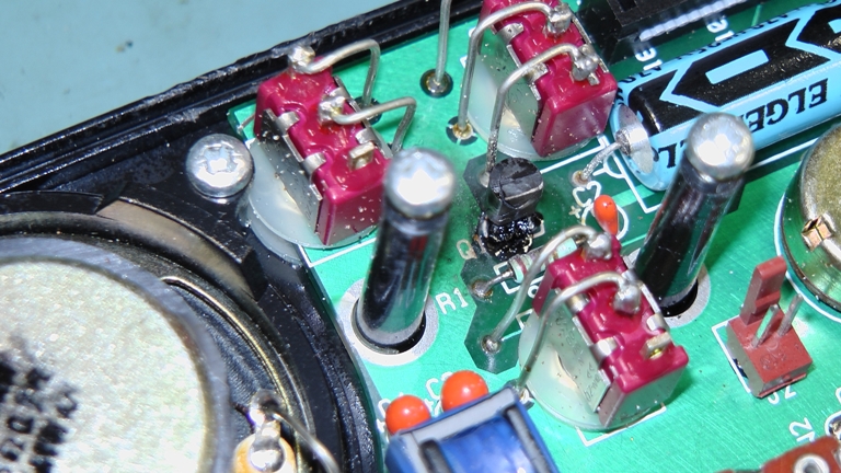

                I found one more problem (I hope it will be the last).
                I have carbonated transistor Q1 on switches PCB as well.
                Please, if some one can help what type it was.
                  Hi Wam
                  Both appear to be BST70A. N channel fets. Looking at the face Drain,Gate,Source
                  The BS170(best) and 2N7000 would work if you can't find the BST70A. The 2N7000 the drain and source are reversed so you would solder it reversed to the silkscreen.
                  The cap is a 22uf/16v tant. D1, Q7 and the TL062 form a 10V regulator
                  Good luck
                  Mark
                    Thank You a lot. I have 2N7000.
                    I have checked data for BST70A (D-MOS, 80V, 0.5A, 2R, 300ms)
                    But I have stronger transistors as well.
                    IRFU014 (MOSFET 25W 60V, 0.2R 7A, 150C)
                    RFD16N05 (MOSFET 60W 50V 0.047R, 16A 175C)
                    IRFU320 (MOSFET 42W 400V 1.8R 3.1A 150C) )
                    I am ready to use IRFU320 type "MOSFET" but original BST70A is "D-MOS".
                    I am not sure if it can be done this way.
                    May I ask Your opinion?
                    Regards.
                      I would be careful replaceing the low current original, with a 6 amp power fet.
                      Those parts burned because something is shorted. They saved the rest of the circuit
                      by acting like fuses. A power fet will just get hot while something else on the board melts if the original short still exist! Try your 2N7000 first to get it going. JMHO
                        Just to say THANK YOU,
                        Before soldering 2N7000 I have found that one of the large electrolitic caps has only one leg solder to PCB (the other leg was broken). I believe it could be due to impact - I decided to secure new capas with silicon, not sure but broken cap could damage 2N7000. Now all works OK. Verry happy.
