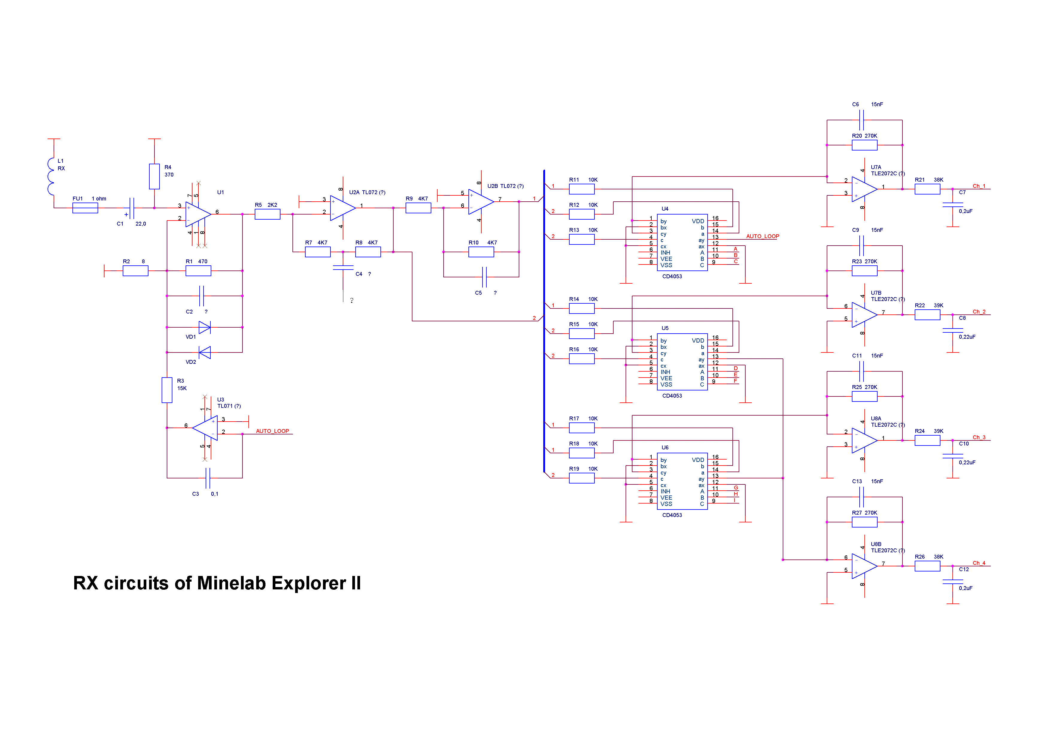

    Andy_F , Nice Work So-Far on the schematic !!!!!!! Are you sure about the TL072 "Dual-JFET low noise opamps" because you have a question mark on the schematic???? The numbers must be scratched off of your detector !!! Minelab as usual ......Anyway , if you get some free time also post "just the TX Oscillator circuit" of the Explorer II . Thank-You and welcome to this Great Forum !!............Eugene
      Hi, Eugene.
      ... because you have a question mark on the schematic????
      Question marks stand there, where not absolutely authentically.
      Yes, but there is an indirect information.
      TX circuit is known for a long time, is the bridge on 4 MOSFET. It is not interesting.
      Operating signals of switches of RX circuit are more interesting.
        RXcircuit
