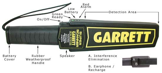

    Did any of you guys have seen inside this device?

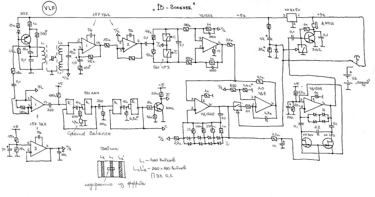

            I'l got this, some values are missing and parts are for Russian market. What to use for replaceing?
            Enybody know?
              Enybody know?
              I think the circuit is not critical.
              Instead of "&" use a CD4093, quad nand gates.
              At 561 use a 4016 or 4066.
              At KPEH5A use a 7805.
              For op amp I think you could use e.g. TL081 and TL074... similar would work too I think. I would use LS404 at quad op amp... but just cause I have many of these.
              At transistors use e.g. BC547/BC548 or say 2n2222 and 2n2907.
              Kind regards,
              Max
                What with resistor on 3-rd leg of 7805?, and diodes??
                  a mistake. deleted. diod is 1N4148.
                    all diodes are 4148?, that resistor should not be in schematic?. I have idea to add vibro and little dd coil instead ferite inside , and make water proof to use when i am diving.
