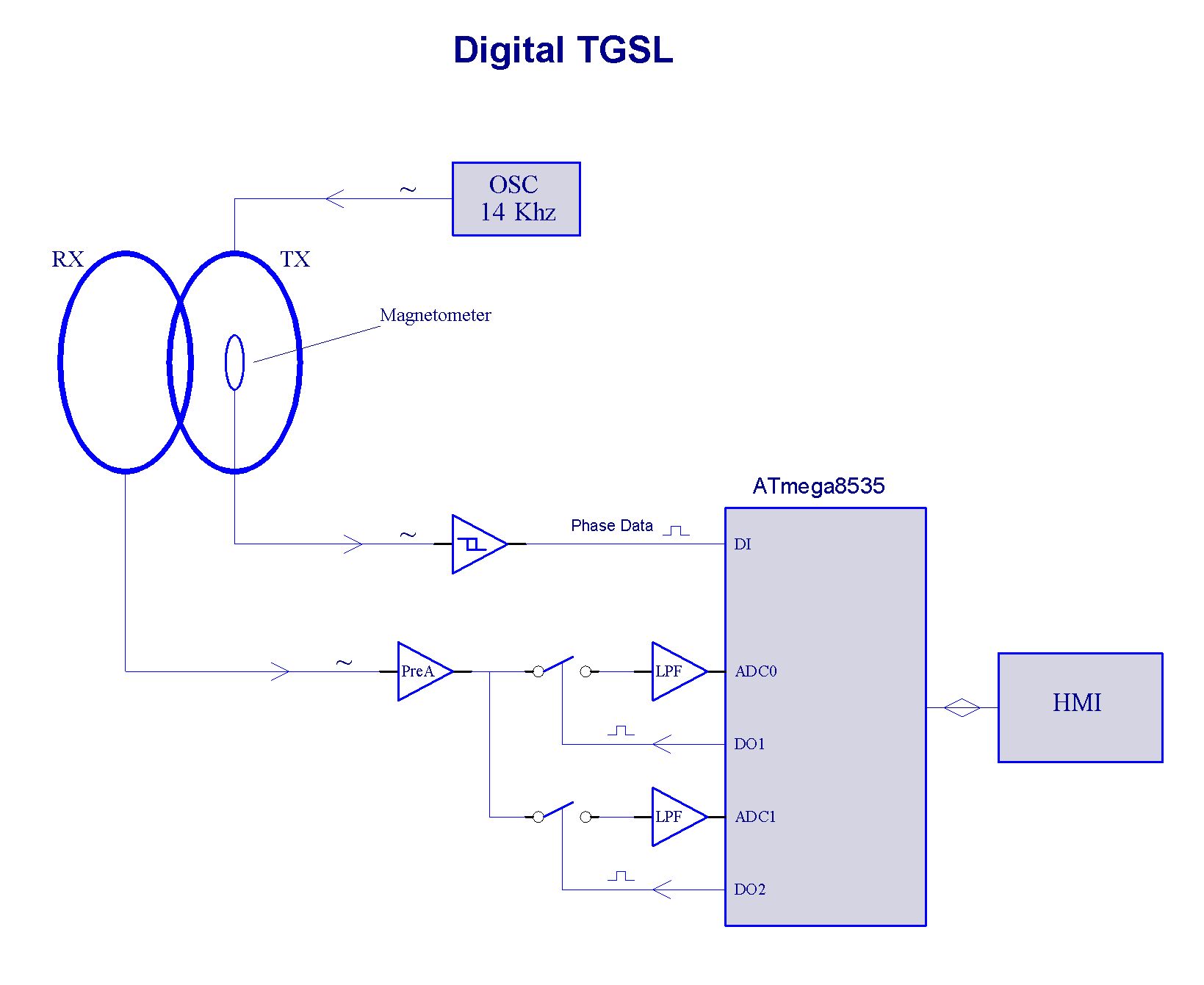

    Do you have Block diagram of TGSL?
    I want to make it with only one demodulator that phase angle of square wave signal changes by a micro(phase scanner).
    in my initial tests i saw some metals change only phase angel and others change amplitude!
    i was confused. i'm searching what? phase shift or amplitude change?
    why the resonat frequency of TX and RX must be different?
    if i have Block Diagram, i can find answers.

    Can you explain in more detail what you are trying to achieve here?
    Why do you only want to use one demodulator?
    Your description is basically correct, but I'm not sure what wild_desert is trying to do. It doesn't make any sense at the moment. We need to wait for an answer.
    I think he wanna use one channel "demodulator" ... some sampling stuff connected to something atmel MCU.
    But the problem is that usually there are two channels... one for geb and the other for disc path.
    In case of amplitude stuff he'll use ADC; for phase issue instead he would use (probably) a comparator only.
    But we know the problem is somehow a bit more complex...

    Originally posted by wild_desert View Post
    Hi Max
    I don't want to do sampling on sine wave, although that is better but the ADC become expensive and busy the micro.
    Let me show a block diagram:

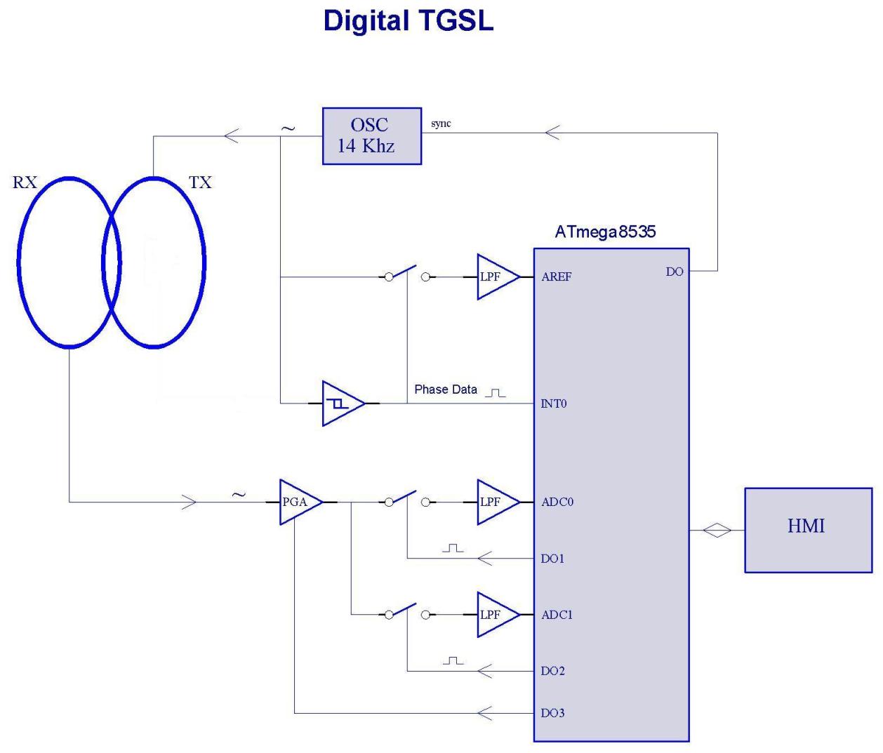

    Hi all friends
    I understand your problems. I caught myself when searching here. But my experiences in MDs is not enough to decide to make a new topic!
    I apologize you and thanks for your attentions.
    I want to start below diagram for making schematic and wait your comments:

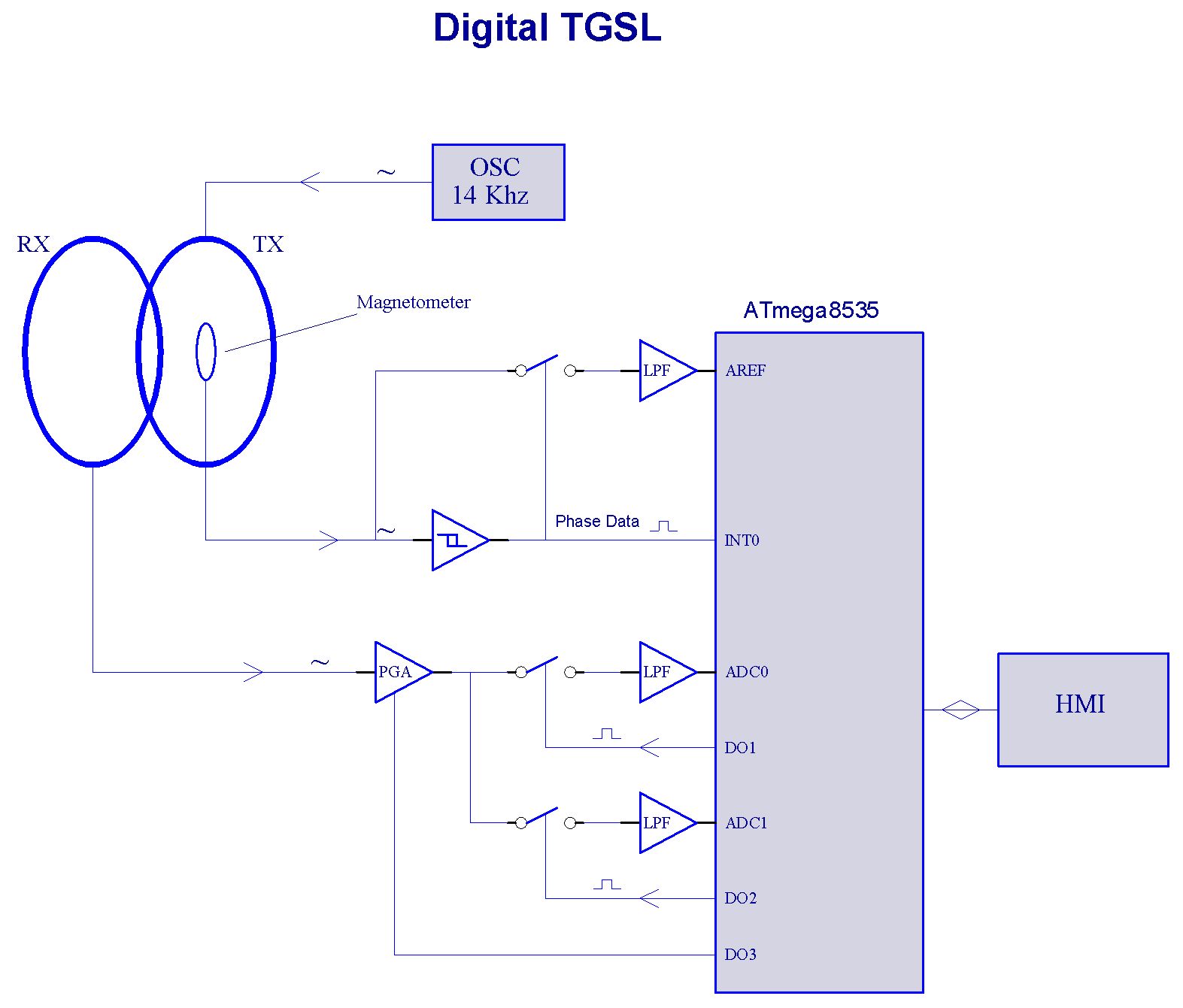

        Hi Max
        My idea is: The magnetometer reads actual magnetic field. Is it wrong? why?
          Hi Max
          the magnetometers are good to find ferromagnetic stuff... flux lines concentrate inside the ferromagnetic "core" and you'll see an increased reading when over the target.
          In MDs you usually look for non-ferrous stuff... valuable items... so why bothering about ferromagnetic materials ?? Iron ??
          That's why you don't need it I think.
          Kind regards,
          Max
            Thanks Max
            Ok
            I edited the block diagram. no other comment?

              why using ADC just after low pass ?
              Isn't better using an op amp in the middle ?
              Kind regards,
              Max

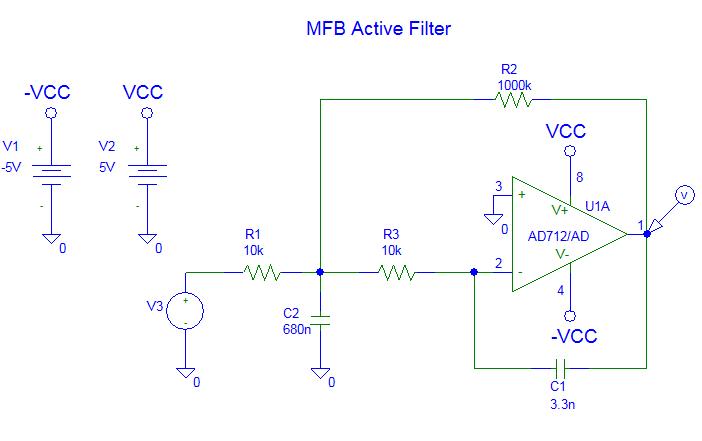

                I was just studying the new diagram and thinking the same thing. The signals after the LPFs have gone through a process of differentiation. You should try putting the RX signal from the pre-amp through a schmitt trigger, as you've done with the TX.
                  Oh, LPF is integrator not differentiator and TX is phase reference! Is it wrong?
                  We can use Active Filters to achive gain and filtering simultaneously.
                  Like below: Order=2, Gain=-100, Cutoff=33Hz
                    yes, you can. Usually in tesoro's designs the first is a passive low-pass filter... then others are, actually, active filters.

                      Why not have a DAC to set a schmitt trigger threshold (like the "sensitivity" control on the Analogue GS)?
                      I think trying to interrupt the Atmel at 14KHz AND process the phase info is going to be very hard (not fast enough). What you CAN do is generate an interrupt when the schmitt trigger fires (target found) and process the phase info then (much easier as you are using the timers to generate the Tx signal).
                      You can bypass this schmitt when setting up ground phase measurements or add a slowly changing channel (FpassMax of around 0.5Hz) and use this inphase with Tx to monitor the ground phase signal (you can then do auto ground tracking and balancing in real time).
                      Your route is the way Tesoro went (doing signal detection in the digital domain) and as we've seen, it didn't work for them. The Euro Sabre sucked HARD, but the old SS uMax ran it ragger (all analog design). This hybrid methodology works very well for Whites BTW.
                      What about switched gain stages and sample and holds to stop signal droop on the LPF outputs?
                      Look for the Eagle Spectrum diagram (somewhere on this forum). That's a machine that got this type of design PERFECT.
                      Just a thought .

                        Thanks a lot Sean_Goddard
                        I'm trying to remove analog parts as much as possible. A good program plus correct use of internal hardware of AVR. Also maintaining constant phase errors in the program is the key of precision and 16Mhz AVR may be fast enough.
                        Your suggested auto GB seems to be analog but we can save ADC values in registers and wait for changes. any slow change may be omitted in program and only uptate GB registers, instead of target alarm. this is my idea for auto GB but i need further remarks from friends.
                        If analog MDs have better history we can change it by effort.
                        Programmable Gain Amplifier(PGA) was used in diagram may be switched resistance. LPF outputs is DC and there is no drop on it. am i wrong?
                        I saw Eagle Spectrum after your post. It is new for me. Thanks. I want to study it in detail.

                          The schematics for the Eagle Spectrum are on the forum. Also you may want to look at U.S. patent 4868910. This is the patent for the Eagle (I think Eagle II) and provides detailed discussion of the circuitry and programs. Much of the hardware and much of the software are unchanged in the Eagle Spectrum, and XLT. Functionally everything is the same. The reading of the White's patent for their VDI (US 6879161) brings in the missing pieces for the Spectrum Eagle.
                          Like Sean said, Whites Electronics got this one right!
