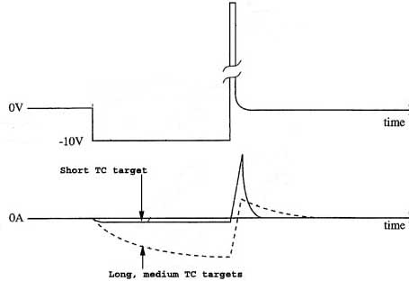

Hello friends,
I will add some more comments on previous post for clearness.
Again: The maximum eddy current of target is reached at MOSFET's avalanche breakdown voltage (or at maximum flyback voltage). At this time, we have a constant voltage level over the damping resistor if the MOSFET is clipping the flyback voltage. It will convert the magnetic field energy with constant rate: P=U*U/Rd. This will last, until the flyback voltage is below the breakdown voltage. Then the eddy current level of the target will decrease exponentially (natural decay).
Did you all think about the time constant of the coil? It limits the rate of time for energy conversion (building up magnetic field energy, discharging magnetic field energy by converting to heat). So this rises a very interesting question about the Q of the coil.
Aziz
