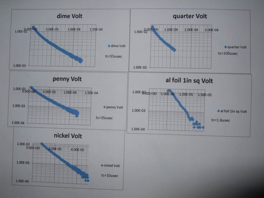

    What is the Target Time Constant? Or target TC?
    If a penny has a TC of 50uS, will it's signal diminish by 64% in 50uS?
    Will the signal reach practically 0 after 300uS?
    Will it take a TX of 5 TC's or 300uS to stimulate the penny to its maximum response?
    What are the TC's of the Nickel? the Dime? the Quarter?
    What is the TC of a silver dollar?

      Tinkerer,
      One thing you can do to see if a target had been saturated by a full pulse, based on the target's time constant (TC) is to start with a low pulse width (PW) about 25 uS and find the distance limit of detection. then, increase the PW and see if that target can be detected at a farther distance. If so, keep increasing the PW until there is no improvement in detection distance.
      What you will find is that certain metals can be detected at low PW like U.S. nickels, small gold nuggets and gold rings. Other targets like copper, silver or clad coins need a longer PW to be detected at their full potential distance.
      Unfortunately a PI coil, PPS rate, delay, and coil current is a compromise as beach hunters would be very happy just finding gold jewelry, but these targets are few and far between. To make the hunting more interesting it is always good to find coins and espicially when the coins are being thrown up on the beach (in the Spring) and being sorted by the wave action. Find a quarter and most coins along that parallel location to the water will be the same size coin.
      So, even though gold is the primary target it is still desirable to find coins. Here is the design compromise. Any transmit pulse width beyond what fully stimulates a gold ring is wasted power from that ring's perspective but is under powered from the perspective of a copper penny that has a total discharge time of 350 uS (reported by Eric Foster on his web site). The copper penny TC is one fifth of the total decay time or 70 uS for the copper penny. A nickel is a good contrast as it has a total decay time of 100 uS with a TC of 20uS. Nickels are a substitute and a good indicator of a PI design/control settings to gold jewlery.
      One design feature of PI detectors is the adjustment of the delay to favor certain types of targets. Low delay for low conductivity items like gold and nickels and higher delay for higher conductivity items like copper, silver, and clad coins. Set the delay too high and possibly miss a small gold target.
      Getting the PI design to operate at the lowest possible delay requires a damping resistor value that is set at a particular range of PPS frequencies and pulse widths. Note that the new White's TDI, designed by Eric Foster operated in the 3,000 PPS range with a frequency control to vary the frequency a few hundred cycles to tune out local noise. This limited frequency range keeps the TX circuit adjusted and optimum for both gold as well as coins.

        bbsailor, thank you for the extensive explanation.
        Do you have any other target TC's available that could be used as reference? Like maybe alu foil? or other fast target TC's that could be used as an universal standard reference?
        Do I understand right, that in order to measure the target TC, the TX pulse has to reach the steady state or Flattop as sometimes called? meaning at least 5 coil TC?
        One last question: considering that the target signal decay/discharge curve, is exponential, does this make the target excitation /charge curve the same way exponential?

          Tinkerer,
          One square inch of household aluminum foil has a total discharge time of 50 uS and a 10 uS TC. Eric Foster mentioned, in one of his posts, that his Goldqust PI can detect this 1 sq inch foil at 12" using an 11" coil at 10 uS.
          Eric also measured a common gum foil wrapper delay times a while ago based on a web conversation we were having.
          Full gum foil wrapper: 25 uS
          Cut in half: 20 uS
          Cut in half again (1/4): 15 uS
          Cut in half again (1/8: 10 uS
          This series would suggest that if you cut the remaining piece in half again (1/16) that is should be detected at 5 uS delay, although I have not tried it.
          Try this on your 5 uS delay design.

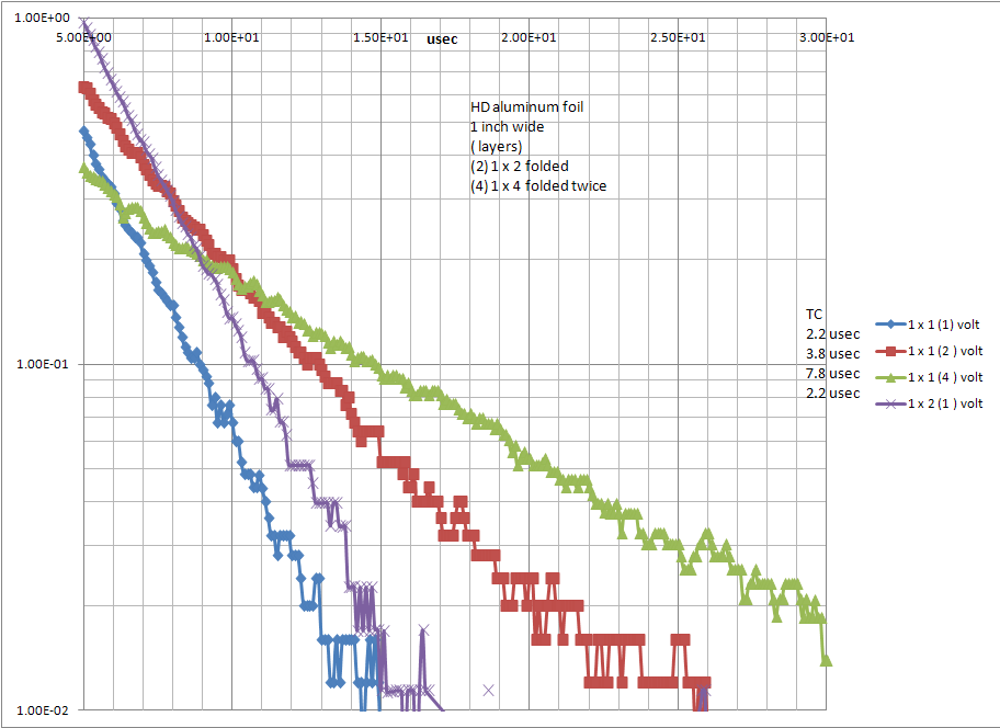

                            I tried some Heavy Duty Reynolds foil. Different foil and equipment from above. Foil was 1 inch wide. Layers were made by folding a longer piece. Each target was the same distance out.
                              In my mind doubling the thickness has the same effect as doubling the square inches of area.
                              Nope, area has a much smaller effect on TC than does thickness. In most targets TC is dominated by skin depth effects, which depends on thickness. Area mostly affects signal strength.
                              I use a set of 1" square aluminum foil targets for standards, with thicknesses of 1x,2x,4x,8x,16x, and 32x. I also have a 1/2" square of 1x and a 2" square of 1x, which has about the same TC as the 1" square 1x.
                              Green's plot exactly illustrates.
