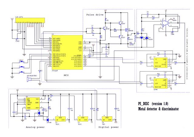

    Hi to all friends,
    I find this schematic in the net, without any more description...
    this is a PI metal detector with micro atmega8
    Please anybody can study this schematic, tell us did thid MD is good for building... , I waiting for your answer,
    with best regards...
    [email protected]
    Well, its not good for building if you have no .hex File or source Code for the MCU.
    A higher Resolution Schematic would be needed, too.
    Is this the Source ? http://sina-madar.blogfa.com/
      This schematis seems a good design,
      please help to write a good program for this ...

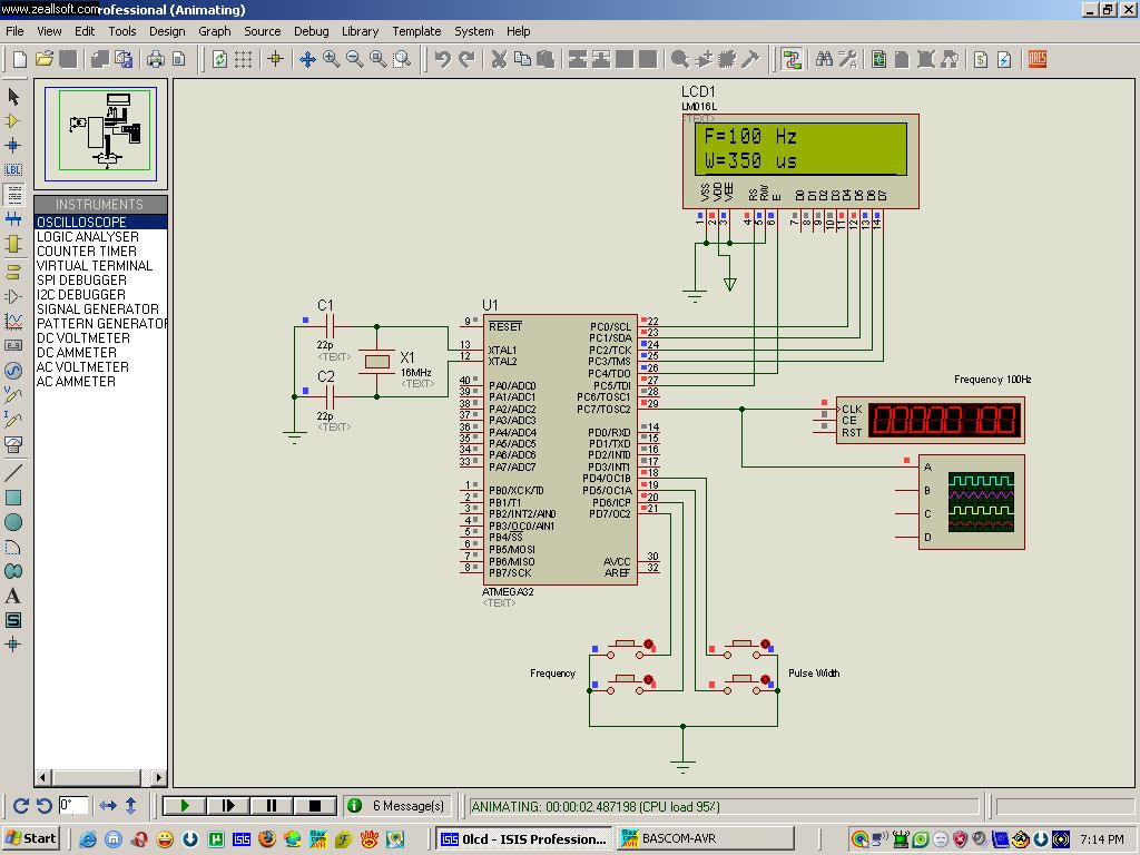

              Hi everyone,
              I am busy to write a program with bascom-avr for my own design PI MD
              to produce pulses with exact frequency and pulse width,
              I write this code for avr atmega32...
              with this program we can control frequency and pulse width in out pulse...
              I am welcome for any good idea to continue...
              Here is my design in proteus simulator,
              In this sample:
              Frequency= 100 Hz
              Pulse width=350 us
              with best regards... zenit52

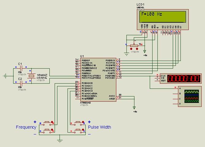

                Hi all friends,
                I write a program with bascom-avr for my own design PI MD and upgrade it
                to produce pulses with exact frequency and pulse width and control them
                by some switches...
                I write this code for avr atmega8 in 16MHz...

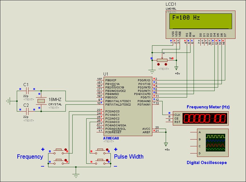

                  Hi all friends,
                  by some switches...
                  With best regards... zenit52

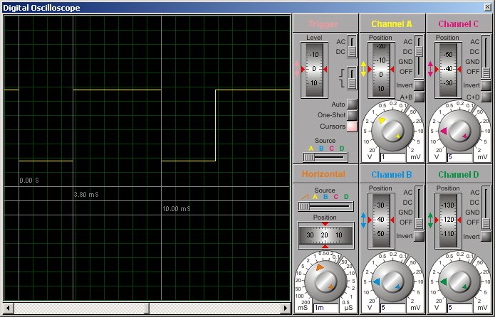

                    Hi Friends,
                    For example Produced pulses show in digital oscilloscope:
                    Pulse width:10ms-3.8ms=6.2ms
                    Period=10ms=> Frequency=100Hz
                    What are your idea about this design ?!!!
                    zenit52
                      are you writing for the aabove schematic ?
                      if so can you share schematic with more resolution.parts can not be read.
                      ıt looks like good but but needs a little bit more amplifying.one or two more steps. using two S&H IC is good idea.
                      I would like to contribute to your project
                      okantex

                          I wante to mean schematic at first mial of this topic.
                            Hi okantex,
                            All parts in picture are clear... !!!
