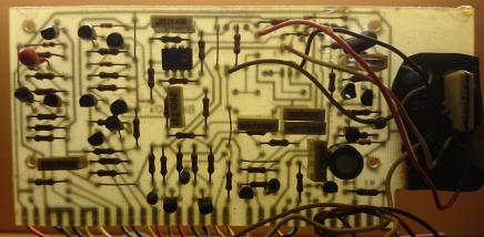

        I know this is old thread. I took photo of TR550D board just in case if it's useful for someone.
        LM358 was broken. I chance it and now it's working ok.
