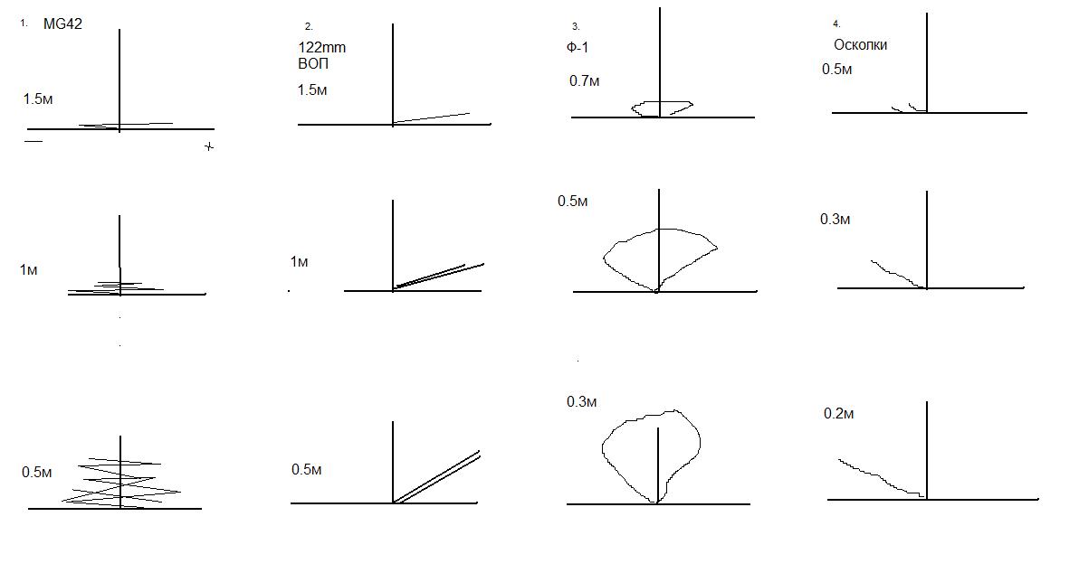

    Sean, say me WHY?! why you do waste a time on this very poor design? why you do not want HEAR what people say you - DO A GODOGRAF. IT IS THE BEST! GODOGRAF gives you GRAPHIC full information, your patriot gives only TWO-THREE DIGITS!
    again I ask you do not waste a time on the squalid meter seems like yet one patriot! you can really blast away the sleeping people if will do this thing!
      I agree, Godograph is best, but VERY impossible as Sovereign ONLY gives a DC voltage output on ONE channel.
      The voltage output is related to the conductivity of the target.
      The UniMeter I am working on also will use the Godograph, AND also a numerical VDI readout of target, but this is for another application.
      It is not possible to make a Godograph meter for the Sovereign, unless I hack around inside, and there is no market for that / I do not have the time for modifications anymore.

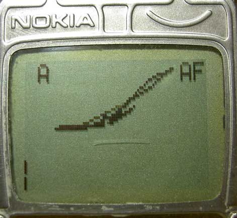

                            /RR/ informs that his new godograf project had been released. please go to the links and see pictures, schematic, .hex etc.
                            http://rr-21.narod.ru/vbox2/vbox2.html
                            FOR IVCONIC. do not abuse people if they want to share some new un-self ideas here. I know your reaction is very aggressive on all new so I repeat you - keep your emotions into yourself ALWAYS.
