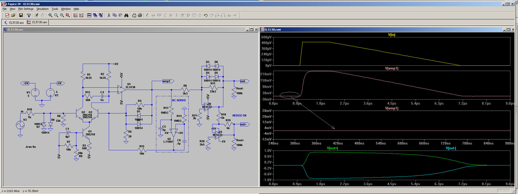

          Of course a simple circuit could be used but I have posted an overly elaborate circuit that includes DC servo offset nulling,
          and complementary outputs. Use part or all of it, or none of it. This circuit was originally designed for use with SSM2210 or
          LM394 where I am showing 2N5210. But two or three parallel discrete BJTs (2N4400, 2N5210(?), etc.) can supposedly
          give very low noise, inexpensively. 2N5210 might not be the best choice in either the current source or the two-legged pair. Experiment.
          Sorry, but I can't offer a good mathematical noise analysis. (Aww, who needs low noise, anyway?)

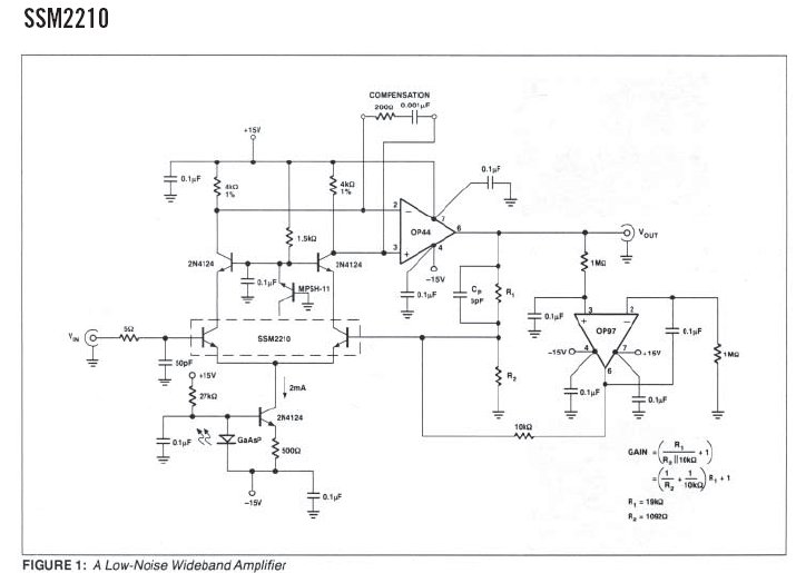

          Included is an exerpt from the SSM2210 datasheet.

              My previous circuit looks good with a small signal input but stability falls apart with a 5V (or 50V, or 200V) input. Minelab uses a NE5534 in a similar circuit in the SD2000 (but without the servo null). 1k is used in the feedback (instead of 10k) and the compensation RC across the opamp inputs has 150 instead of 560. The circuit is stable but overload recovery is not so great.
              SD2000 uses a blanking gate so it's hard to say what the highest voltage the preamp input would be subjected to. Being as how the primary sample occurs at about 15us I wondered why a blanking gate was necessary. Well, it very likely because of poor overload recovery characteristics.
              Sorry about the bogus circuit, and getting off-topic.

                As for your circuit, it is very much the same as the sd2000! To get lower noise from it try parallel ssm2210, or even some mat02 devices. What does the DC servo offset nulling do? The highest voltage that the sd2000 preamp is subjected to is bugger all! Maybe .6v.
                  Hello unregistered. The purpose of a DC servo loop is to reduce DC offset voltage to (sub)millivolt levels even without using a potentiometer across the opamp's null pins. So, theoretically you could plug a viriety of opamps into the same circuit with total disregard to the null-pins configuration (whether it be 1&5, or 1&8, or whatever) and still have almost zero volts offset at the preamp output.
                  There are some problems, mainly that the DC servo loop components add about 1.5us to the settling time of the circuit - even after hand selecting compensation components. Another problem I'm finding is that with these composite amplifiers there is a need to custom select the compensation components. So, they're tricky to set up. But I think it could be worth the trouble because I forsee low noise, fast response, and fast recovery from overload. I just need to work out the BUGS.
                  One issue that hangs me up is that a some manufacturers have spice models for their opamps but for some reason they don't model the compensation pin(s) if they exist. That's part of my problem now - one opamp that I thought has great promise (and a half dozen of) has a compensation pin that the spice model completely ignores. Well, there are other fish in the sea. Of course, I could always just plug one in and see what happens. It's like having a shed full of broken garden tools. (Or no tools.)
                  And so, I thought I had another "candidate" opamp along with a composite amplifier circuit to post, and it worked fine - banging it with a 400V jolt, but when I reduced the input pulse to millivolts the amplifier's stability dissapeared and I have a high frequency sine wave riding on what should be a flat peak. Sort of the opposite of what I had the other day - working great at low signal levels and falling apart with a HV input. There is that unmodelled compensation pin that might save the day, or might not. Buh.
