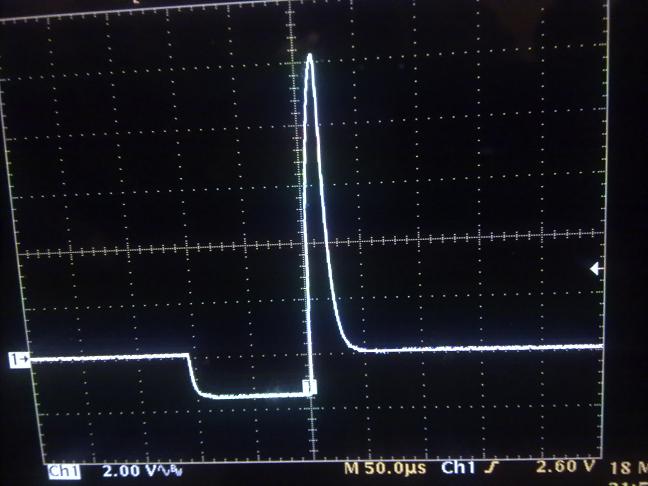

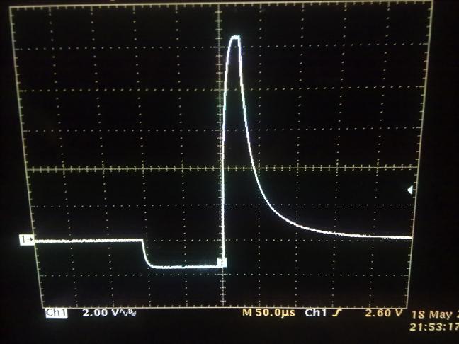

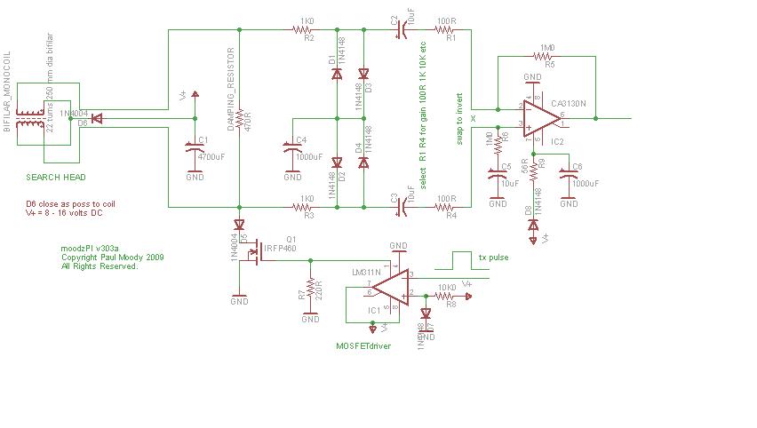

        updated circuit ....
        v303a
        enjoy ... moodz.
        NO TARGET
        20 cent coin
        • #79
          There have been some changes as previously mentioned ....
          Isolating diodes have been added. There is a gotcha with differential circuits and that is when noise gets into one side of the circuit and the will not reject it as it is not common mode. The 1n4004 diode on the mosfet will reverse bias as the flyback pulse falls ... why because ... the MOSFET looks like a capacitance to ground when it is off and this will charge via the diode ... when the flyback falls lower thant the peak charge the diode will reverse and the junction capacitance will isolate the relatively huge transfer capacitance of the MOSFET.
          The CPU I am using ( dsPIC ) can easily drive the MOSFET directly ... however there is a relatively huge transfer capacitance from the gate to the drain and this will couple RF hash on the gate lead to the driven side of the differential circuit again unbalancing it and causing differential noise. NOTE ... this would also impact standard PI designs ... so check for noise entering via this path. The LM311 is a quick and dirty way to achieve high voltage ... high current drive and no RF hash from the CPU drive line.
          Likewise D6 provides isolation of the coil after the Tx pulse ends. It also provides a bias point for the clamping diode system on C4
          Notice that the opamp is fully isolated from DC at the inputs. After all we are amplifying pulses ( AC ) here. The opamp will bias nicely to approx mid v+ and you can see this in the scope pics in the previous post.
          When the circuit is first turned on it may take 10 seconds or so to stabalise as C5 has to charge via R6 to provide the bias point.
          At the moment the only voltage regulator is the +5 volt reg for the microprocessor. ( not shown in the schematic )
          The coil I am using is fairly ordinary so I will be looking to speed this up next .... however I feel that the output is already good enough to feed into the A2D converter in the CPU for processing.
          will post more info ....
          any suggestions welcome.
          moodz
          • #80
            You still need a DC path on the + input.
            • #81
              Hi Carl .... its buried away in the data sheet for the CA3130 ( page 7 on the intersil specs ) ... to quote ...
              DIFFERENTIAL DC VOLTAGE
              (ACROSS TERMINALS 2 AND 3) = 0V
              OUTPUT VOLTAGE = V+ / 2
              If I isolate all inputs with low loss caps then this works.
              So i dont need any biasing to ground. The DC value across the inputs is 0.
              So this amp has no DC gain and the caps appear as very high impedances DC but low impedances to the pulse waveforms.
              I have used this trick in a number of places.
              Another example of this type of self biasing is to take a hcmos inverter and put a 1M feed back resistor from the output to the input. The output will settle to VCC / 2 and you can use the device as a type of crude amplifier.
              moodz.
              • #82
                Hi Moodz:
                What is the value of the damping resistor? It looks like 470R....?

                • #83
                  It reads 470R to me
                  • #84
                    Hi Moodz:
                    -SB
                    Simon ... 470 ohms.
                    I have also tried placing the damping resistor right at the coil .... seems to have a marginal benefit.
                    moodz.

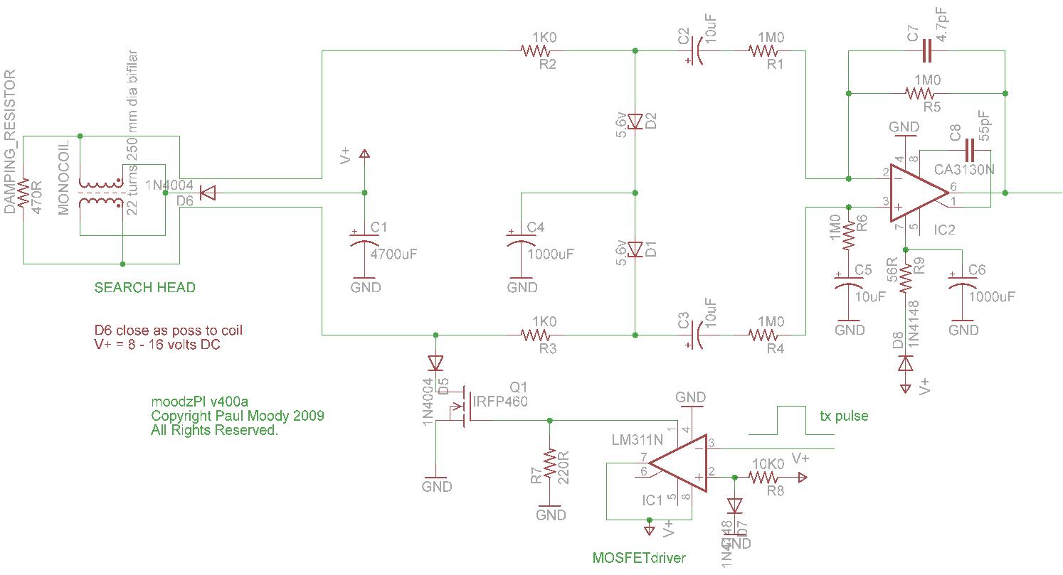

                      descrimination for moodzPI
                      ... well the adventure continues ...
                      The last frontend v303b was perfectly good as a frontend for a standard PI however the ability to analyse the conductivity of the target would be very handy ..... some might call it descrimination.
                      So ... v400a is posted below. Note that the 'clamping diodes' have been replaced by two 5.6 volt zeners. The amplifier now has a gain of approx one. ( yes 1 ) and for those who build this circuit and examine the waveform out of the amp you will see very interesting behaviour at the peak for ferrous vs more conductive targets.
                      The post processing will now take place at two points ... at the peak and the base. ( ie two main channels to the cpu )
                      For those who cant be bothered building the circuit yet well ... Ok ... Ill post some scope pics on the next post. ( gotta get my points up for Carl's comp after all. )
                      cheerz all.

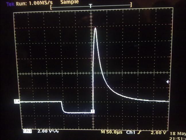

                      • #86

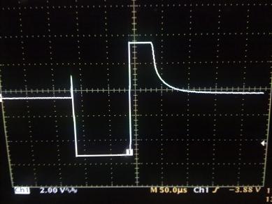

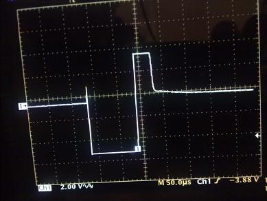

                        descrim pics for moodzPI v400a
                        well here they are ...
                        First one below is NO TARGET. o/p from amp in v400a schematic.
                        Second below is copper target. Note the base response but the peak is a little lower ( not much change )
                        Third is below with steel target. Note BOTH the base and the peak get 'fatter' ... now you should be able to guess where the two places where the post processor will be sampling.
                        cheerz from moodz.
                        • #87
                          Oh yeh ...
                          Both targets 10 inch square.
                          Tx pulse = 100uS
                          Coil the same one as per schem.
                          moodz
