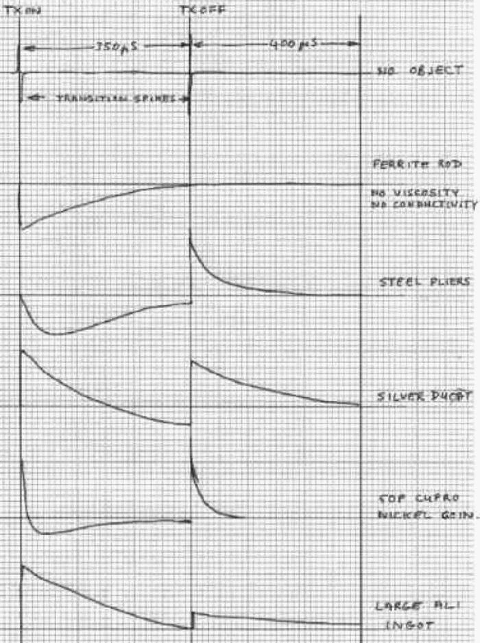

        Now, let's tackle the other persistent myth. Hey, I like the "Myth busters"
        The myth says that the ON transient can not generate as much Eddy Currents as the OFF transient. Laws of physics are blamed for that. After all somebody or something has to be blamed for our mistakes no?
        I keep insisting that this is a fallacy but my whining falls on deaf ears. (Didn't use the right language, dahh..)
        So lets look at this explanation, does this make sense?
        Hmm maybe I should make a sketch, they say a picture is worth a thousand words...
        Looking at the sketch,
        a) represents the TX coil current with about 1.5 TC, at switch ON.
        b) and c), from post #43, the fast and slow Flyback.
        Now, look at the "area under the curve" which one is the largest? Ooops, small mistake here, will have to come back on that later.
        d) is the TC current in black and the target response in red. There is a lag between the target response and the stimulation. As the di/dt diminishes, the stimulation of the target and its response diminish. This slowdown is a bit exaggerated on the sketch.
        e) is the TX charge curve with a "flat top", like a about 6 TC. The response of the 2 different TC targets (red and green) raises with a time lag, relative to their TC. The lower TC target (red) has reached its peak earlier and as the di/dt diminishes, the eddy currents start decaying.
        The longer TC target (green) lags more, the time is too short for it to reach its maximum eddy currents.
        OK, this is the first try at drawing the picture. It is not all that good, but maybe it gets the idea across and somebody with better skill and knowledge could improve on it.
        Tinkerer
        Hi Tinkerer - I'd like to understand better your diagrams.
        First, I'm not sure what you are demonstrating. Are you demonstrating that TX turn-on can have stronger target response than TX turn-off? Or are you illustrating two different TC targets' response to TX turn-on? I'm confused because graphs b and c seem to be about TX turn-off, but I don't see how they tie in. Would you explain b and c a little more?
        Looking at graph e, are you showing that a longer TX pulse allows the slower target current to grow more and therefore maybe there is an advantage to the slow turn-on phase compared to fast turn-off?
        I have a couple of thoughts about that, which if I were smarter maybe I could show with equations. The first thought is that when we detect a target, our detector coil responds not to the peak current of the target but rather to the peak rate-of-change of the target current (same physics as the target responding to the rate-of-change of the TX current). So really in graph e it is the fast up slope and fast down slope that makes the received "signal". I'm not sure how that affects your point, but may be relevant.
        The second thought is: is what you are getting at like the concept of "tuning", where the target responds better to a particular wave shape than others? For instance, suppose our target is underdamped and would "ring" in response to a pulse. Then it would make sense to create an on-off pulse that turns on and off at the ringing frequency so as the magnetic field reversal kicks the target in both directions synchronously with it's natural oscillation. I could buy that, although it would mean only certain targets would benefit from a given pulse width. Perhaps there is an analog to underdamped targets as well.

                  For certain targets, we can read a higher signal amplitude response during TX on than after TX OFF.
                  Consider a target with a TC of 5uS. Sampling at the very moment of maximum response, during TX you can read this maximum value.
                  Sampling the same target 15uS after switch OFF, you will get at best 5% of its maximum response.
                  For graphs b) and c) please refer to post #43. There you can see how the response of the target lags behind the excitation.
                  The same happens with the ON transient. The response lags behind the excitation.
                  I agree that the strongest excitation happens with the moment of highest di/dt, but there is a time lag between the "charge " of the target. Commonly we represent the target with LCR. So we can expect an exponential charge curve.
                  The unknown factor is the values for LCR, but we have the known factors of di/dt and the total time of the exposure of the target to this factor.
                  What we are trying to do with discrimination is to calculate the values of the target's LCR.
                  My graph e) shows the signal generated by 2 different targets, during TX only.
                  Now, if you use both the responses generated by the ON transient and the OFF transient, you have the information that would be generated by a low frequency and a high frequency VLF.
                  About "target ringing" I have no information yet. During my experiments I often found this "invisible sine wave" and was wondering if this represented a ringing target. After all, the eddy currents expand throughout the target, but where do they go when they have reached the far end? are they reflected back? If yes, ringing could be possible. Just speculating.
                  Now I believe that the PIVOT as a part of the "invisible sine wave" is simply a different Tau.
                  Tinkerer

                              B^C,
                              Your pictures appear to be what we would see with a balanced RX coil, which is just IB? The time base appears to have been changed in each picture along with the pulse train so it's hard to say what we are supposed to be looking at?
                              • This picture was originally drawn by Eric Foster and posted on the PI forum. The cupro nickel's waveform might look dramatically different to the silver ducat's and al ingot's, but note that it is just compressed time wise, ie, just a shorter TC. You might also see why disc is very difficult when ferrite is mixed with a coin, or even worse, a gold nugget.
                                Some proposed disc methods rely on the coils being critically balanced, such as we might have on the work bench, but this can be rather meaningless if the ground upsets the balance.
                                Eric's explanation for his waveforms here...
                                http://www.findmall.com/read.php?34,...778#msg-129778
                                I hope you realise that ML know these waveforms extremely well and you might eventually see why they favour square or rectangular transmitted waveforms over a PI on-period.
