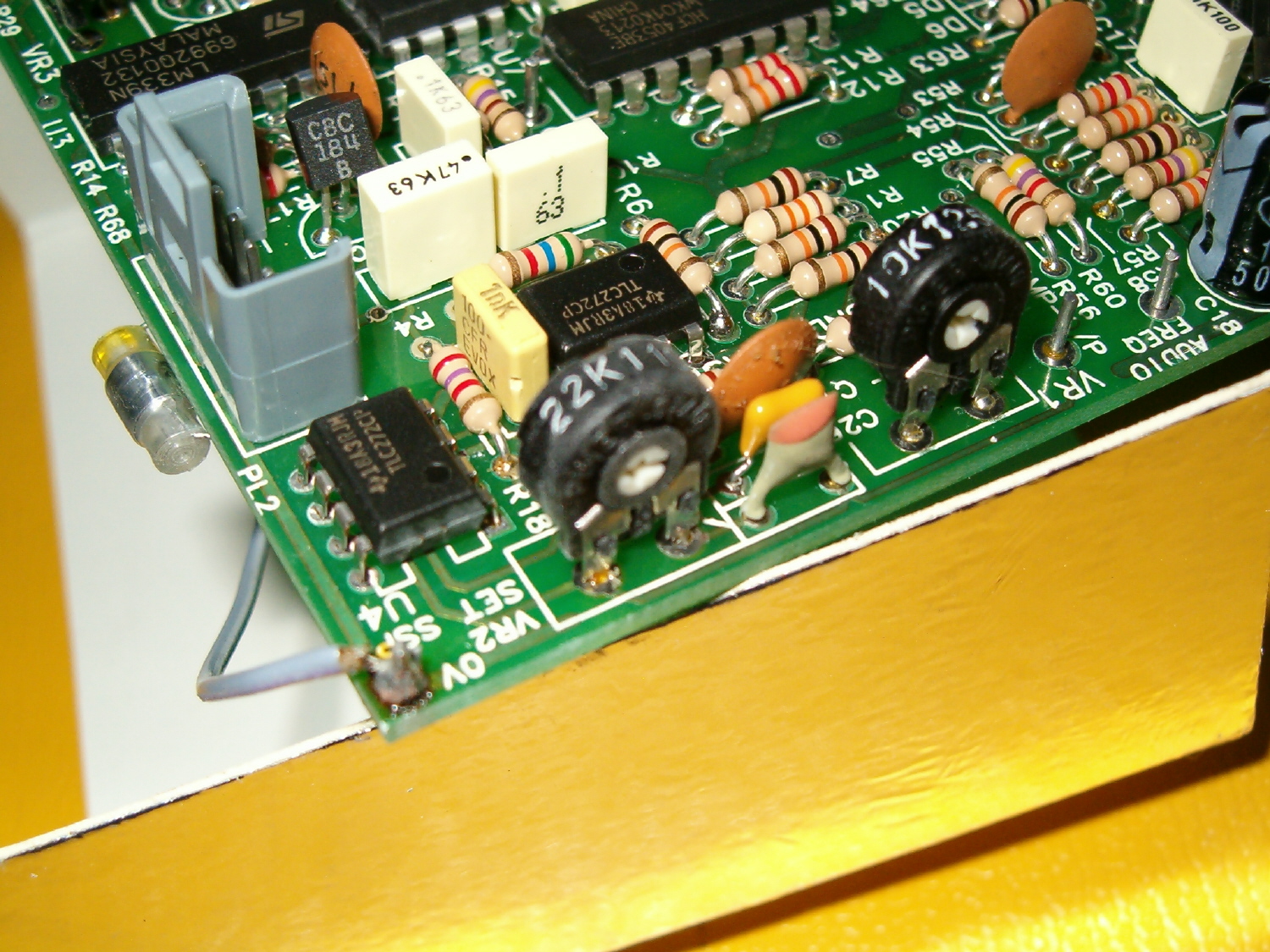

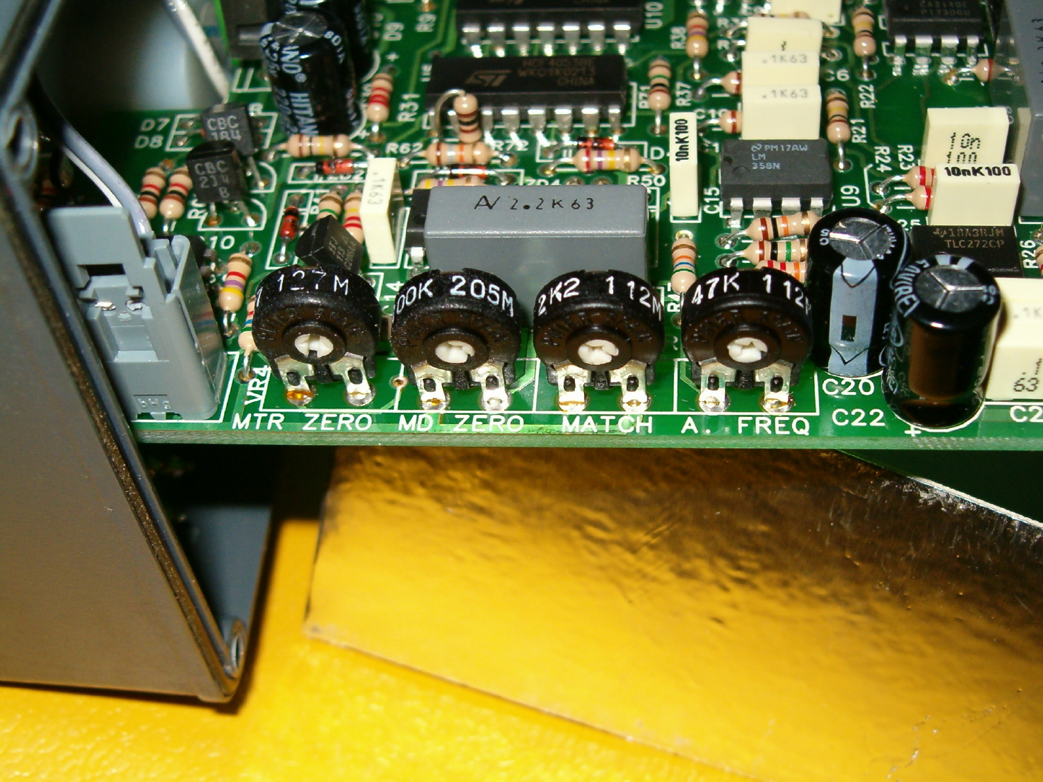

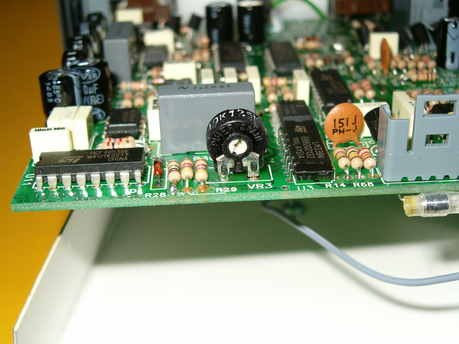

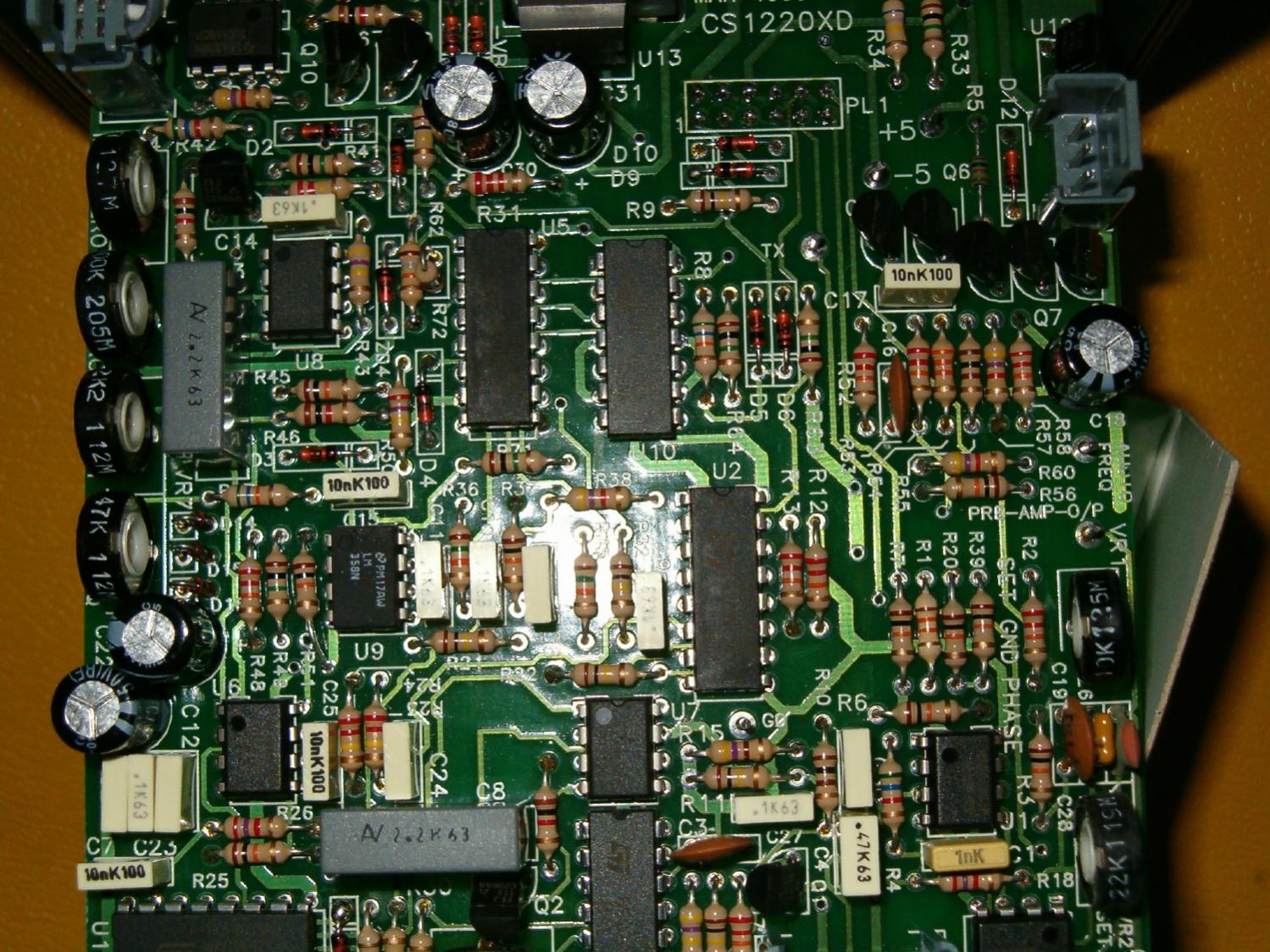

    Have just taken some pictures.
    Does anyone know which is the coil trimmer please

            I attached Pcb and I will sent other informations later.
            Best Wishes
            Erol
              Erol...i saw pcb there..hmmm..i dont think XD and D versions are the same machine. That version you posted looks much simplier than XD i have. Once i opened 770XD box, was curious and wnated to se what's inside. I was amazed with what i saw inside. It is not simple at all. Very complex machine but packed at very small space. Reminds mostly on photos we have here, which ASH posted already - photos of 1220XD, although 770XD is a bit smaller and simplier. I also recall some "770" model i saw in the past. It was very simple and poor performance detector. Maybe it was "D" version. Give me some time and i will take photos of my XD and post here also. Than you will see differences.

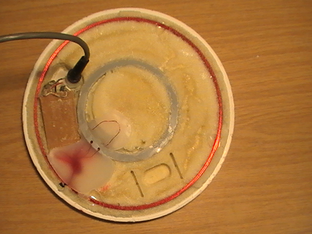

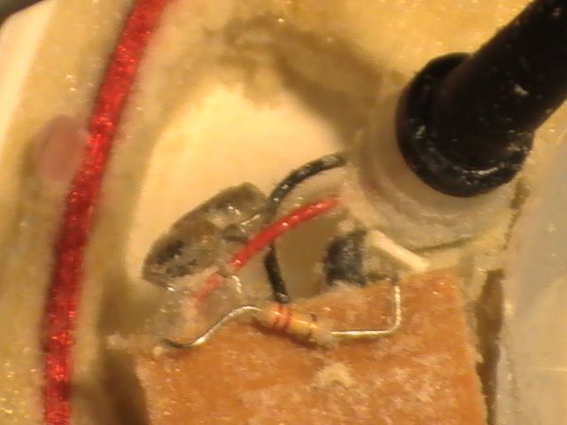

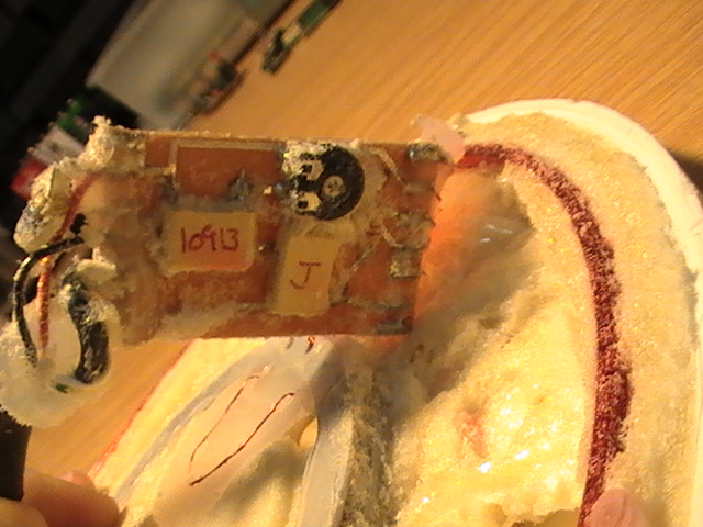

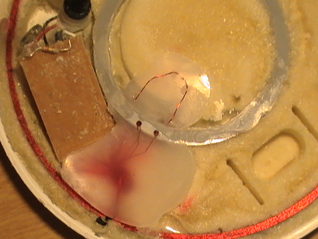

                As far as I am aware and from my own experiments with C-Scope machines, the trimmer for the coils is located inside the coil housing itself on a small circuit board. I think this is only used as a final nulling due to small tolerances due to the manufacturing process of the coils.
                Ash, Your 8” coil should work perfectly well as long as it is from one of the models that operate on 17KHz (I think the R1 works at around 7KHz).

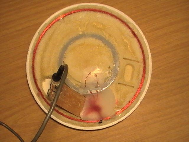

                Here are some photographs of a C-Scope 8” solid coil from a CS660 that I recently opened up in order to experiment with and make some shielded double ‘D’ coils.
                On the DD’s I did away with the whole board and just placed a 47nf poly capacitor across each coil. The oscillator being a Hartley type these set the frequency. Then I just null the coils in the normal way with an oscilloscope.
                I also own a CS1220XD with 8” coil, a CS770XD, the CS660 mentioned above and a CS4ZX. All have been fitted with XLR sockets and plugs on the coils.
                I find all the coils are inter-changeable (including my home made ones) on each machine.

                      As to your coil Ash, let me suggest that you 'reverse the phase' of your TX coil within the plug of the coil, that is to simply swap over the red and black connections inside the plug. Solder the RED lead to where the BLACK one is and then solder the BLACK lead to where the RED one is.
                      C.Scope appear to be not too fussy as to witch way around they connect these leads to the socket at the factory and then match the phase on the plug later when setting up. Maybe that is what they mean when they request the machine is sent back to them for trimming. (Clever marketing or what).
                      I have configured all my C.Scopes XLR sockets & plugs so that the coils all connect in the correct phase.
                      Other than this I can see no reason to 'trim' the stock coils as they all seem to be fairly accurately 'nulled' at the factory, probably on a reference oscillator as opposed to individual machines.

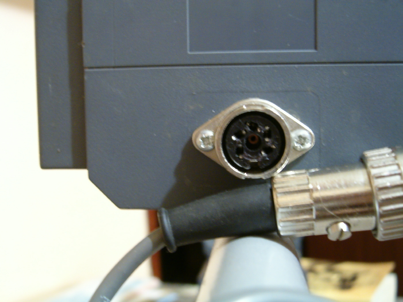

                          As you say the coil on these machines is ‘hard wired’ but both the coil itself and the connections are indeed the same so they would be compatible.
                          The 660 can be a very reasonable machine too by the way so if you were to buy it you could maybe add a socket to the 660 and a plug on the 8” coil, then you would have two machines with interchangeable 8”/10” coils.

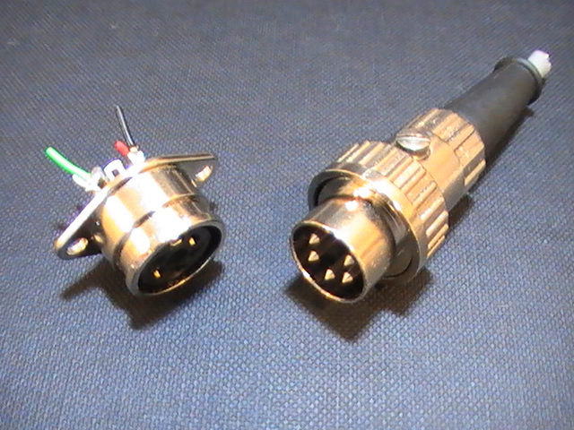

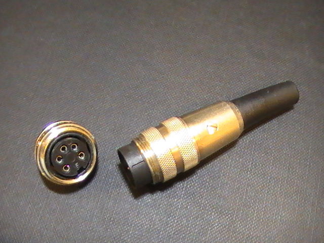

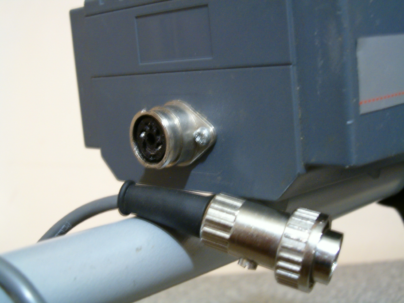

                          Is the plug on your coil a bayonet type or screw in? As I have a spare plug and socket that you would be welcome to from either my 1220 (bayonet) or CZ4ZX (screw) both have short lengths of cable still attached.
                          I will take a photo in a little while and post on this thread and if the same just let me know?
                          Russ.
                            plugs & socket pics
                            1st pic Bayonet type (should be this one) and screw type, let me know Ash?
                              Many thanks Russ,for the very kind offer of the coil plug fittings. I am more than happy to pay you for them though.There is also the cost of the postage to consider.

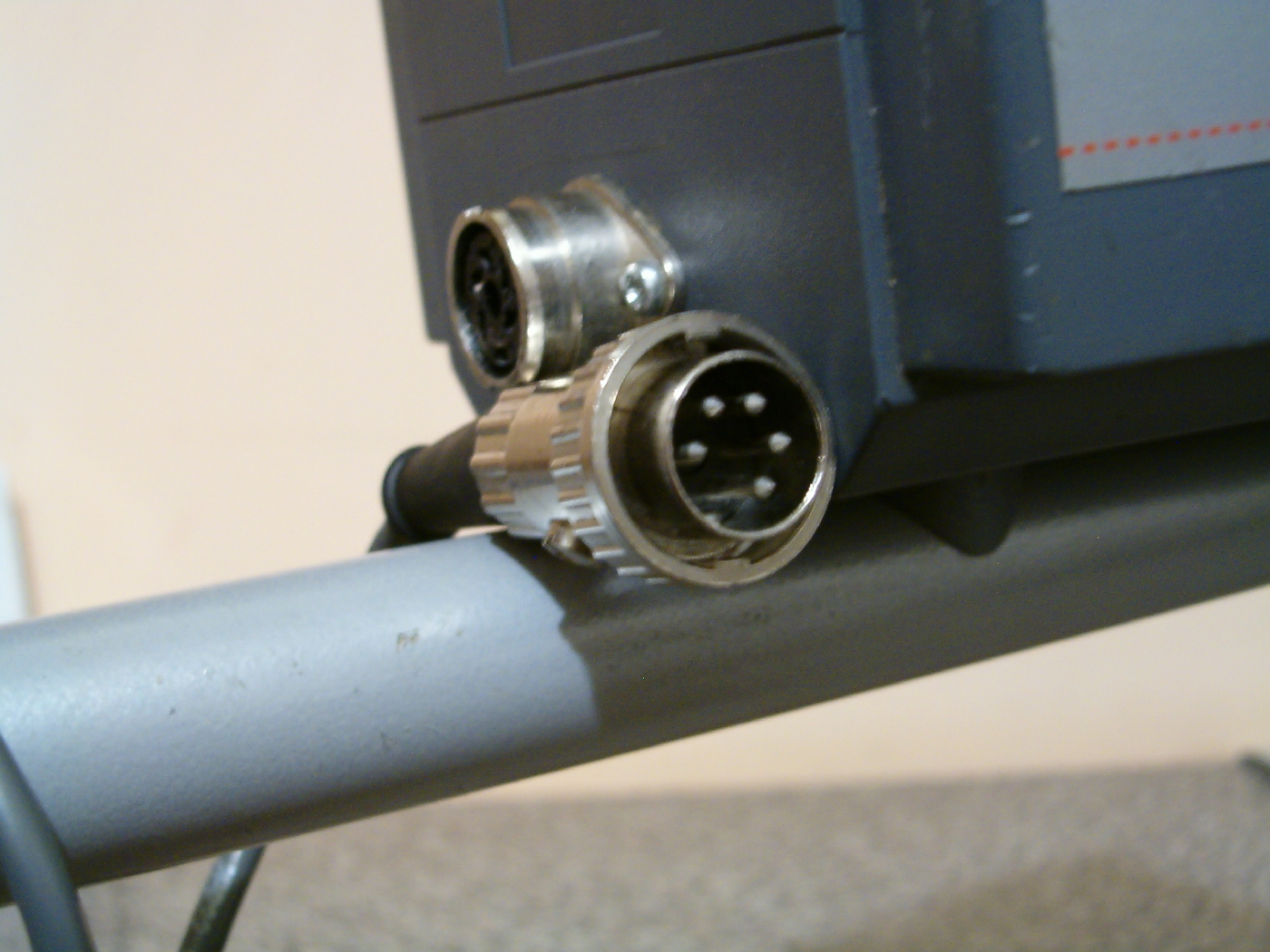

                              I have included a few pictures of my coil plug etc. Hope they come out ok.
