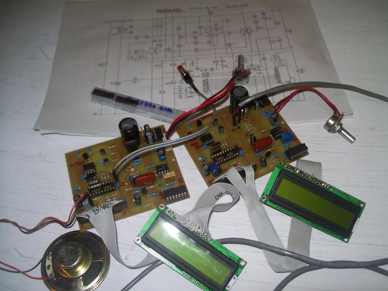

    Hi ,Ive done search here on the forums,an limited result?
    I got two old goldpic PCB built an complete,Not by me! but checked an correct.as per Net. data etc. Just they got no Pic micro with them?
    Ive purchased a couple of new Pic 16F84a as per original.
    Ive got Pic Programmers x2 a JDM serial port an PicAll2 ,including softwares
    Pony Prog. WinPic, an Ic Programmer an Others. to put code on them.
    Just I got no code??
    as per discusuion on forums an elsewhere, this original Pic would have its code Locked an not accessable as is a credit to its developer. If I had the original supplied Pics. they no doubt probably work!
    Ive got nothing but 2 pcb complete an 2 new purchased Pic micro.
    I would supose that the Author original .T.Hill no longer suports this old PI device after 10 Years or whatever from development ?
    Told that the Stuart PI code is similar ,but wont work on this?
    Anybody at all developed a working code for this ,for Pic16f84 chip? an tested??

    Hi Rov,
    Sorry to give you the bad news, but checking on the web site http://home.global.co.za/~trh/#Project it looks to me the project is very much alive and the author still sells the semi-kits.
    If you can't find the source code or the hex file, I would suggest to try to modify the available code from the Stuart PI. You will soon realise there is quite a lot of work into developing a functional detector based on a microcontroller. If you manage to write the code, please share it with us

        Hi Rov,
        There are also source codes for the metal detectors, but unless you want to use them exactly as they are, it is useful to learn a bit about microcontrollers. Choose one type and start learning. There are plenty of examples and tutorials on the internet and it is an exciting process to get the microcontroller do what you want. I am also a beginner and I've done already a few basic programs, that flash leds, control stepper motors, generate beeps, etc. I use PIC16F628 at the moment.
        For PIC microcontrollers, I recommend the tutorials from http://www.winpicprog.co.uk/
        As a programming platform, I use MPLAB provided by Microchip themselves and this time I decided to do everything the difficult way, using assembly language. I am already able to generate the three pulses required for the Hammerhead and store the settings in the EEPROM, but I want to add a LCD screen and buttons to adjust the settings
        The conclusion is that, if you want to do it, you can do it. It might be a longer road than you first expect, but it could be very rewarding. Split the project into small bits and concentrate on one bit at a time. Then you put them all together. By the time you finish all the bits, you will have more experience to combine everything.
