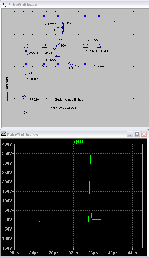

    I was thinking for some time if there is a better way of damping the oscillation of the coil instead of using the classic circuit, with Rd in parallel with the coil. I thought, what would happen if we would place the damping resistor in circuit only at a very specific moment in time? Could that improve the decay time? The discussion with B^C today motivated me to check my theories.
    Here is a screenshot with my circuit diagram. I don't know if it works in real world, but I expect some close enough results. I think the most important adjustment would be to generate the control pulse for transistor U3 at a very precise moment in time.
    Here is the circuit diagram and simulation results, also the LTSpice simulation. With this circuit, I expect to be able to obtain sampling pulses very close to the flyback. The coil should be a concentric coil or DD coil, since the limiting diodes would worsen the decay time (or maybe to connect them via another switching transistor for the monocoil circuit).
    For LTSpice simulation, place the file nemos3t.mod in C:\Program Files\LTC\SwCADIII\lib\sub, the file nmos4.asy in C:\Program Files\LTC\SwCADIII\lib\sym.

    This is a very interesting idea ... I have not tried it on spice but I have tried to do it on a breadboard ... could not remove ringing in the receive response. The spike is like a rollercoaster ... must apply the brakes evenly and constant or you get jerking. There is a patent where they have a circuit like yours but no resistor ... by applying correct bias to gate you can use the mosfet as a damping resistor ... the patent suggests DAC or variable resistor. An interesting variation might be to provide feedback to an error amplifier which compares the decay to some ideal / reference decay signal and controls the gate biasing to vary the resistance of the mosfet accordingly.

      US Patent 7075304 - Variable damping induction coil for metal detection

        Thanks for the information about the patent. One would have expected that other people thought of this long before me. I briefly checked the patent and it is quite interesting, they are using a DAC to gradually increase the damping current, and they don't use the resistor at all. In my case, the resistor also has to have a specific value, like 50 ohm or 100 ohm (I tried with 20 ohm and 200 ohm and the effect wasn't as good)
        The paten is obviously a more evolved version than mine.
        I am surprised you already tried it on a board, you are very fast! Based on my simulation, the adjustment of the control pulse for the damping transistor has to come exactly at the right time. I think that is at the peak of the negative voltage, and the required precision is like better than 0.1us (100ns!). I am not sure if you can obtain that resolution on your microcontroller. If you go more than 0.1us to the left or right of the right point, the ringing will occur again, with a higher and higher amplitude. I think people without microcontrollers can use a monostable and a pot to finely adjust the point. But I don't know if it works.
        I am not sure how your suggestion could be accomplished in practice. How would you generate the ideal reference signal? I think it would require a DAC and some preset data from a microcontroller. I also think the error message is not linear with the required control voltage of the damping transistor. My simulation shows I have to open the transistor completely at a specific moment in time for a short period of time, and in rest, it is better not to have any signal at all on the gate. But, of course, I could be wrong.

          I tried it a couple of years ago, incredibly sensitive to the exact placement of the timing. Decided it was impractical.

            I was using a PIC and coding in C so the timesteps were not exactly what you call precise ... maybe it could be done with a really fast FPGA or state machine.
