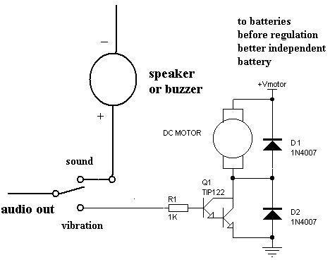

    I am looking for a circuit to build a device that will vibrate when I get a signal on my underwater detector. I am wanting to use it instead of head phones. Any help would be appreciated. Thanks, Mark

        Ok... the vibro-motor for cell phones is powered usually at 3V (even less) ... anyway 3V are usually enough for it, you just need an adaptor that converts the audio signal (or visual) of your MD to the supply required for the motor... just that.
        In case of motion detector it could be necessary adding a small monostable (i.e. 555 circuit) to have say min. 0.2 seconds of triggering of vibro... otherwise some will not be so responsive to immediately start and you'll lose depth.
        Just a transistor... maybe a monostable, output stage and vibro.

                You can select both mode:

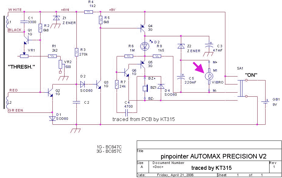

                  Mark, you may take the vibromotor from automax precision pinpointer (or what p-p you could find around from...). put also some part with Zener diode, capacitor and transistor. voltage of the Zener you may calculate from your conditions...
