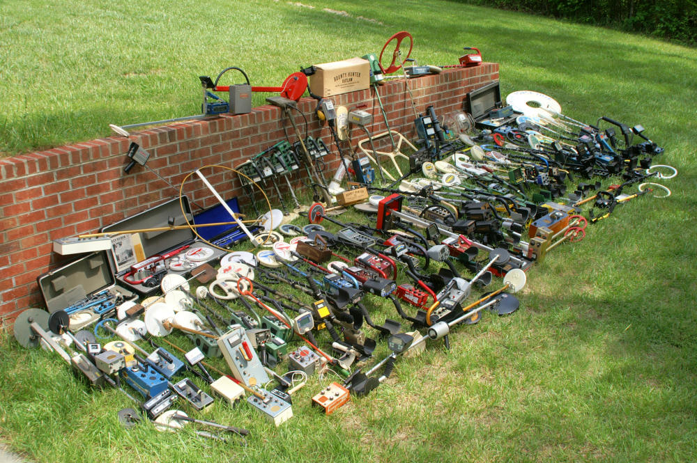

        Did you read the link I posted at Gary's Detecting? The hoard test shows that a 1kg hoard of coins could not be detected at 24" depth by any detector. Carl also duplicated this test and was unable to detect it ... even with his massive collection of detectors.

                Do you see the very large white coil in the top right of the photo? Even this detector could not detect the cache. Nor could any of the 2-box detectors.
                I would not say that it is impossible, but I do not know of any commercially available detector that could detect a jug of coins at 1m. It would have to be a very specialist piece of equipment.
                According to Georgi at Nexus, the Ultima with the dual 20" (88 x 52cm) coils can detect a 20kg hoard of various roman coins at 145cm. This is about as good as it gets.

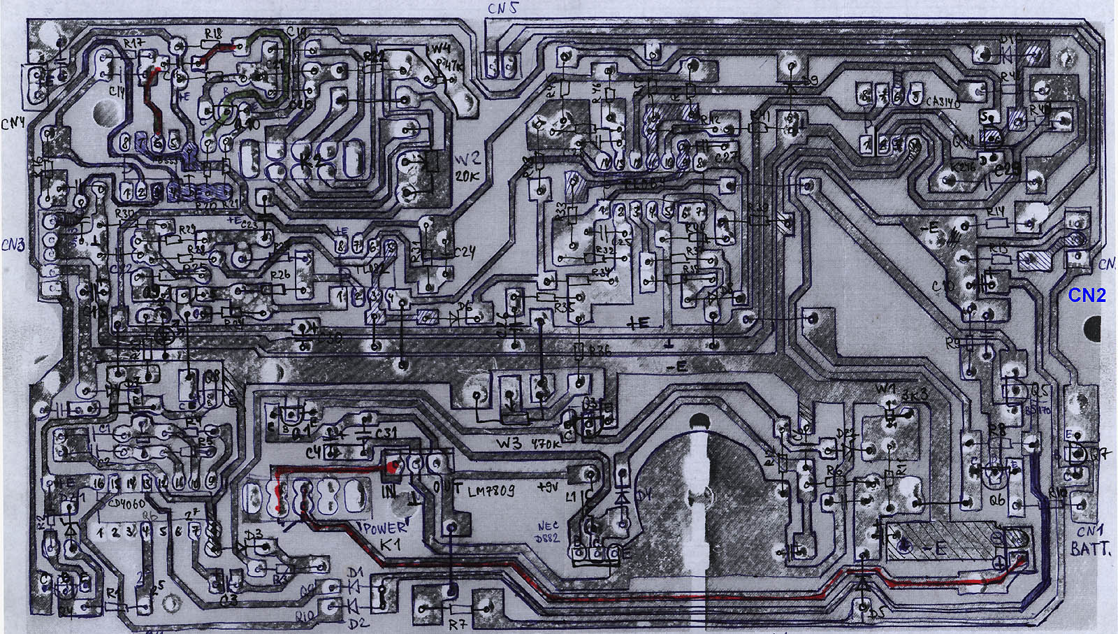

                  PCB of 5008. IMO this schematic seems like 'updated' version of Magnum and Shadow. if you dream to build Magnum do md-5008... the schematic is clear non-motion, novadays it is 'very oldest and forgotten' technology for monster brands like FISHER, TESORO, MINELAB etc... but you must power on your mind in spirit of china-men... in spirit of wild eastern Asia Chingiz Khan mongol plague... and to try to take up and use the oldie technology too...
