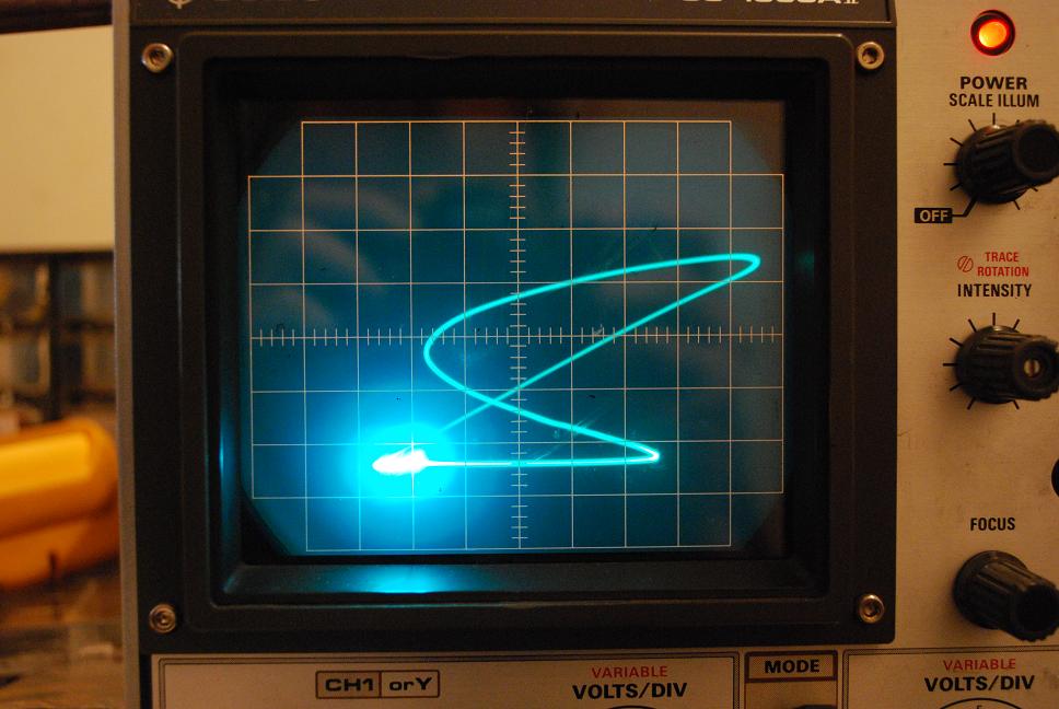

          I thought i would share this & try to get some comments on it, others may have observed the same thing?.

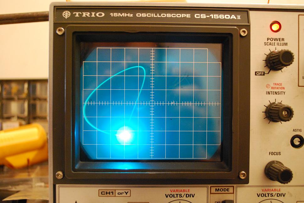

          I have like mentioned been trying to get a close look at what exactly happens at the target & i found something that at first i thought was faint noise or something affecting my readings from my Target Cell.
          Taking a closer look i found the strangest thing & it appeared to be the faintest signal within a signal if you can believe that, i didn't at first.
          On trying to amplify & enhance the signal i was surprised to find an endless type of loop signal, which i called Signal-X?
          I worked on this for quite some time trying to amplify it without destroying it & found i could shape this into a figure eight.
          Sound like i'm frigin crazy just writting this let alone you reading it, please keep reading & you will see what i am talking about!

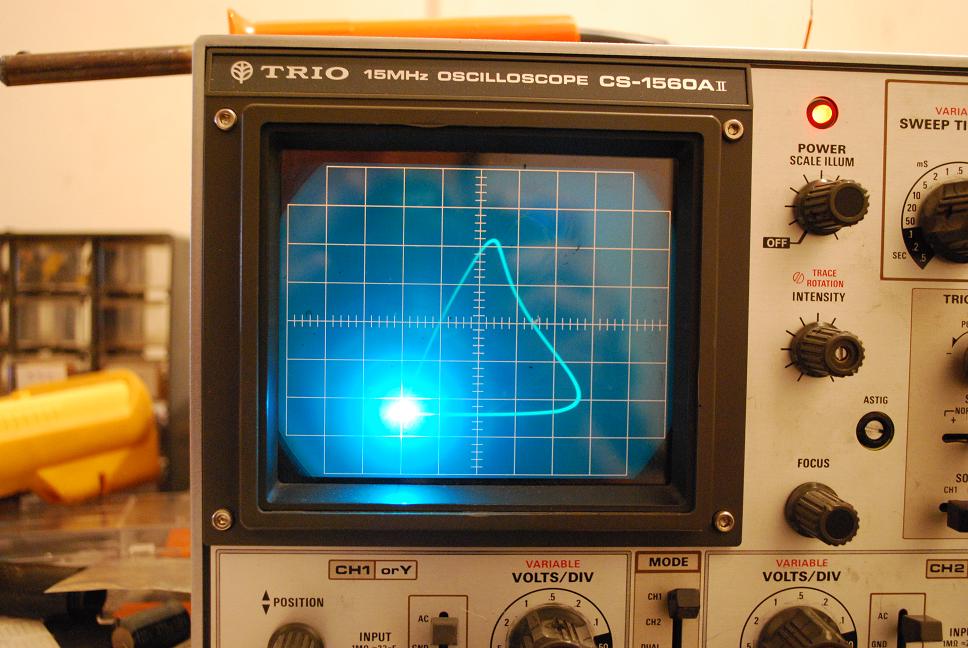

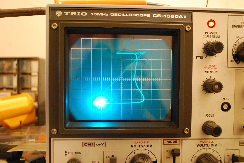

          Now when i place a Ferrous Target into the target cell it loops out to the left with testing & with a nonferrous target it loops out to the right with testing, i was astonished by this. In saying that it doesn't take much to get me interested in something anyway.
          See what you think but to me it appears to show the Eddy Current Impedance Plane & with the Ferrous Target making a more pronounced loop to the left due to the ferromagnetism-Permeability.
          Someone with a bit more Nouse than me may find different?
          I can invisage that it may be possible to actually get a real visual on a target with this but that's an even wackier story.
          The first picture is a very amplified shot of the signal i found.
          The second picture is the much worked on figure eight signal.
          The third picture is with the Ferrous Target--loop to the Left.
          The Fourth picture is the Nonferrous Target--loop to the Right.
            BC could the non ferrous loop be the diamagnetic properties that things like gold or bismuth exhibit. A test on that would be to use a bismuth target to see if the signal is possibly proportional to the diamagnetic of the target .
            Wyndham
              Gday wyndham,
              Ah, yes, i have to be honest & say i completely overlooked the diamagnetic properties when thinking about this, this is indeed a good thought & worth looking into.
