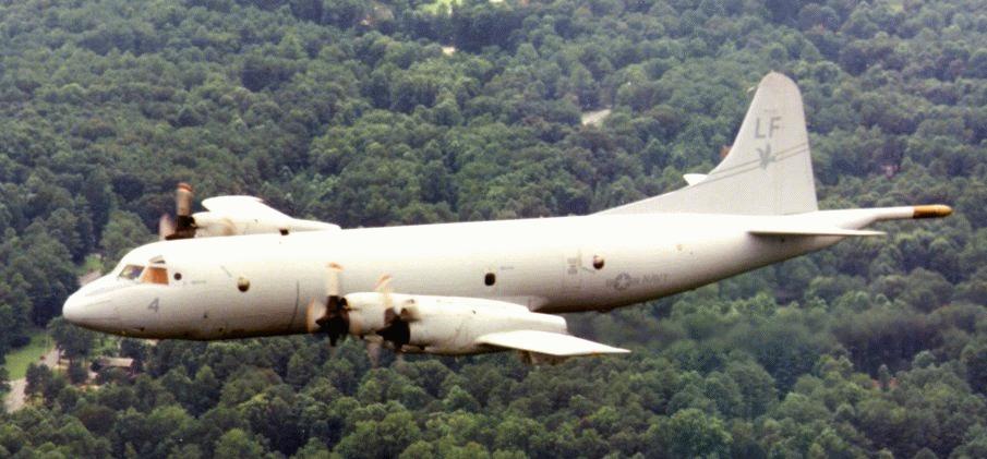

      I think also that common, fluxgate, magnetometers/gradiometers are not good for that stuff... you need very fast reading... like in this stuff...
      The P3-Orion has one in the tail (look at picture... the yellow tip in the rear is the sensor housing)... as I remember... anyone could confirm that ?
      The Orion uses that fast reading mag to scan sea for submarines (made by titanium alloy mostly) due anomaly... but... as someone said... can detect other stuff...
      I think some retired USAF/U.S.NAVY could confirm that.
      You need something similar... but maybe a plane is required to take sample readings.
      Sure all that stuff do not apply to small non-ferrous target stuff... I think it's impossible for a mag detecting e.g. a gold coin buried, deviation of gradient is too small.

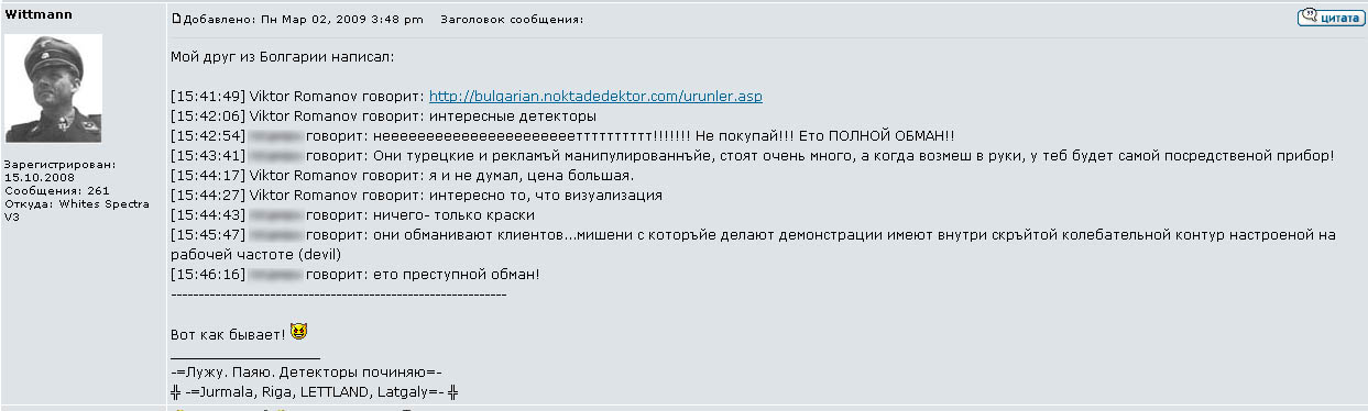

                  I never seen any night hunter using Nokta products in Turkey. Consider their claims like LRLs. Also I see now why kt315 kicked from Russian MD forums.

                          I keep your money. in Turkey. it is why I was kicked in Russia. there are many forums and BELIEVE me I give ONLY one answer on Nokta dream box. you know WHAT.
