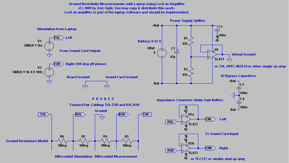

                        Hello,
                        I have been experimenting with using my laptop that way.
                        Actually there is a software perfectly suitable for such a task
                        http://www.daqarta.com/
                        I did some field testing. The current from typical soundcard output seem to be just enough for such device with 6 meter array.
                        The software generates signal, and records it through microphone socket, measuring the voltage.
                        However, I cant get sensible results. I think it must be something with the signal generated.
                        I used the left channel with a sine wave at 1Hz. It seems to produce za current, but it seems to be in only one polarity. Im a bit confused, how the signals should look. Should they be off-phase by 180 degrees? I dont get it. I thought one sine wave was enough.
                        Could you please have a look at the software, and generate a proper signal for me? Then, you could save a config file nad send it to me, for testing.
                          Hello Baresel,
                          the sound output offers only few volt output. It depends on the type of brand.
                          Stimulating with differential lines, you can double the output voltage.
                          Line1: sin(w*t)
                          Line2: sin(w*t+pi) = -sin(w*t), pi=180 degree phase shift
                          Differential output voltage: Line1-Line2 = sin(w*t)-(-sin(w*t)) = 2*sin(w*t),
                          where w=2*pi*f, f=frequency, t=time, pi=3.141592654
                          Most sound cards did not have a stereo microphone input (most mono only). As microphone input line has often additionally 20 dB gain (x10) option for increased gain, the input impedance might be still quite low for this application.
                          For a better and independent configuration, a simple stereo fet amplifier/buffer or even an instrumentation amplifier could give the possibility to measure high impedance and tiny signals. Probably some of the low noise microphone pre-amps could also be used.
                          As the signals/currents through the electrodes are ultra tiny on dry ground, you need to measure in differential mode only. Any EMI can be cancelled and will not disturb your measurement much.
                          I don't know the software, you have found. I only use self coded software. And the lock-in amplifier technique is really destined to this application. The time constant for the lock-in amplifier could be increased heavily (tens of seconds or even minutes), to resolve even nV signals. You can outperform most of the measurement devices then.
                          Aziz
                            Hello friends,
                            if somebody wants to experiment with ground resistivity measurements using laptop and lock-in amplifier, the following basic schematics can be used. I have tested it and it works perfect for simple measurements. As I am using a high impedance op-amp (max. 10 pA input bias current, 10^12 Ohm input impedance), high ground resistances (like dry ground) can be measured.
                            The "difference amplifier" doesn't exist here and it is done in the software by simply doing "input signal = input L - input R" or vice versa. The lock-in amplifier can take the transmitted signal as a reference. For much higher ground resistances, an JFET instrumentation amplifier with high gain would be convenient. In this case, a single ended signal can be fed into the sound card input (one channel only).
                            Aziz
