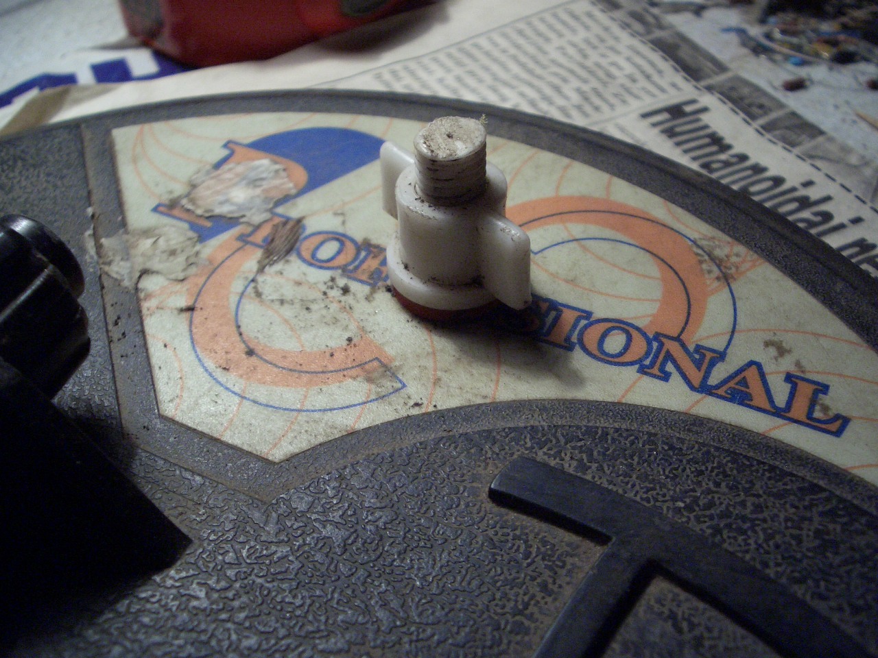

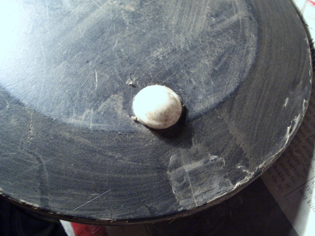

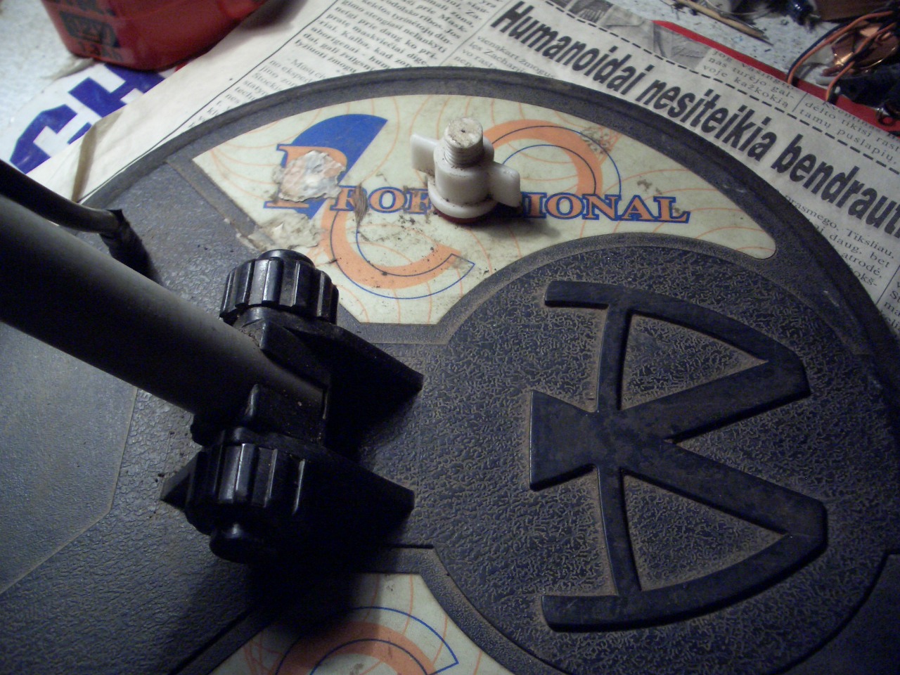

                    maybe slightly seems wild for you now... it is a mechanical type coil tuning for MD-5008. kinda some coil balance... I do not know as it is NOT my invention a buddy says 'i tune a coil on maximum sensitivity. it is working good'.
                    I present the idea...
                      yes I see... but I've made already! It's in some mine LRL implementations... at coils... (btw also that LRL stuff don't work, of course)
                      I used nylon screws that found in an hardware store that sell boat stuff... so many inox and plastic screws and fixing there... these are good places where to find them.
                      Even more easy... some bath stuff uses that too... for jar covers and the like... but other stuff too... same reason... lot of water around and simple e.g. zinc/iron stuff don't last enough... make rust etc.
                      The idea is interesting applied to existing coil...
                      Clever ! I like it!

                        What is clever? What do think it is doing, how connected?
                        -SB
                          -SB
                          it's mechanical stuff....
                          if you e.g. change/modify alignment of coils (or even position of shield in some cases) you can tune coil to work better... I mean get lower nulling or right phase.
                          In this case I'm not sure... but seems to me this stuff apply a controlled deformation on coil housing that's enough to maybe get better performances.
                          The idea is not wrong... if you assume coils are not directly accessible cause there's potting on them... a good alternative could be a slight deformation on housing... small but enough to reach scope of better performace.
                          Of course... that means the coils are not perfectly rigid stuff... e.g. the potting compound is not totally rigid epoxy thing... ot that the shield in housing can follow a little deformation if applied...
                          The idea is much like adding extra stuff like tiny foil strips to adjust after potting... or even a metallic washer there...
                          The screw thing let me think the guy who used that stuff found he can screw the thing untill get the desired behaviour then leave it alone.
                          That's similar to old MDs... which used fixing screws for coils nulling stuff... you null then screws fix correct position... then can add some e.g. epoxy/superglue on them to prevent any further movement.

                            only got this hi-res photo of the coil inside... enjoy
                            http://i37.tinypic.com/207ufir.jpg
                              fantastic -- thanks.
                              Maybe adjustment screw compresses small coil in series with bucking coil???? What is it?
