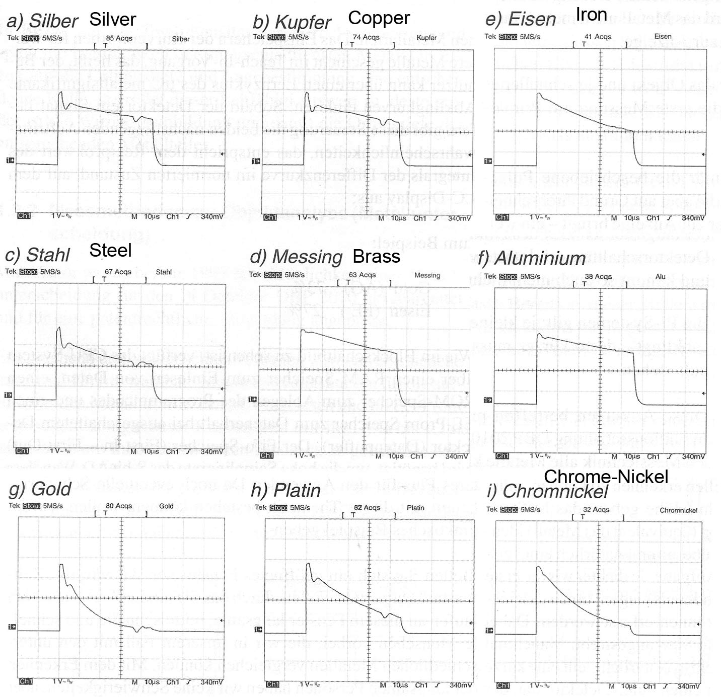

    Hi ,
    can anybody add PI delay times here
    I need delay graphs of different metals and no metal graph
    Hi Okantex.
    I don't remember exactly but the curves that i attach is from a Turkish site. I think that you are from Turkish also
      Yes , I remember it ,hehe , thankss ,

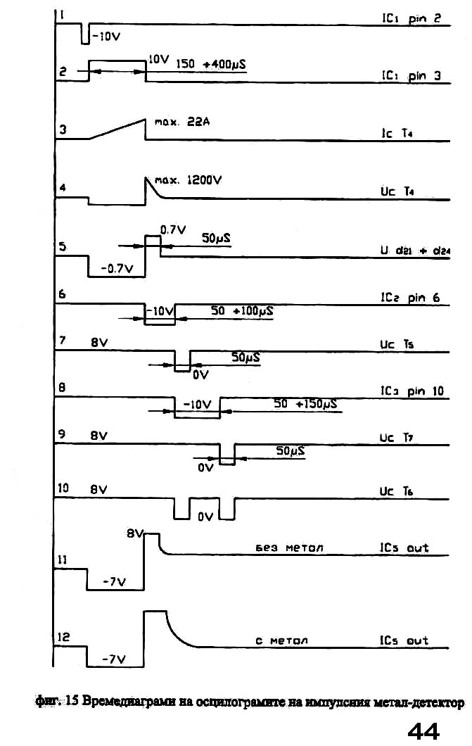

      but since internet world is too big , I can not find a page second time.
      anyway ,I also need graph without any metal.
      reagrds
        look waveform 11 and 12. 12 is with the metal existing
          Geo, I think that turkish and russian (11 and 12 waveform) diagrams are not measured at same test point of PI detector.
          Interested at which test point are measured turkish diagrams?
            Of course was measured on different detector. As i see both are at the output of first amplifier. For Russian i am sure because it write this. On all PI detectors after the point that is aplied the delay signal, we have not again this waveform.
