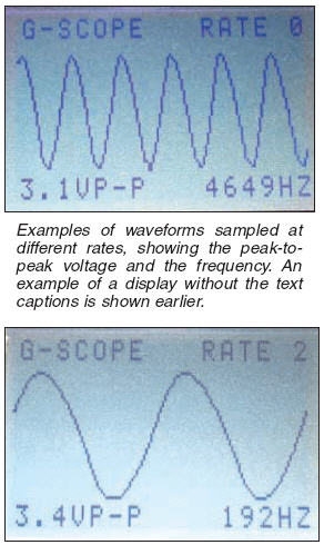

    John Becker (all tributes to his geniallity) posted very interesting project in EPE Magazine, May 2001 issue - "PIC Graphics L.C.D. Scope". It is simple, one-channel scope based on PIC16F877, using LCD graphics module 128 x 64.
    Splendid little one project!
    Most benefitial is its size - it is very small and compact, yet doing pretty descent job, covering majority of amateur measurements. It can show scope vaweform, amplitude value and frequency at the same time on display. Low consumption and very compact.

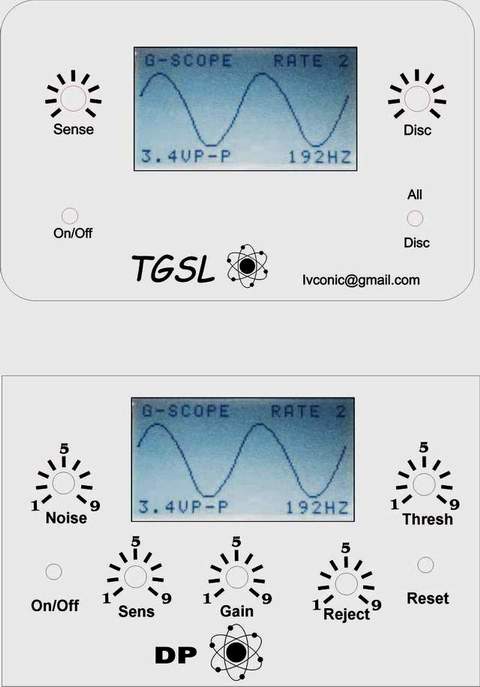

    Looking at Tinkerers PI project and reading his interesting discoveries i got also interesting idea; how about if we include John Becker's scope in finall md design? Instead of projecting other way of indication, we can simply use already made scope and include it in md design with use as detailed indication of some processes in device. With some multilateral switch it could be switched between check points in design and observed various points of Tx-ed or Rx-ed signal, as well as to scope finall output signal which usually goes to indication stage (audio,scale or whatever).
    Scope is small and compact with low consumption, it could be easy included. Doesnt occupies much space but offers more features than ordinary indication we are used to meet so far.

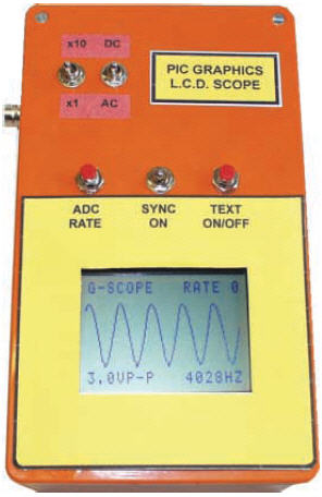

    PCB dimensions are 58x84mm + LCD 128x64 (packed over), so it can be packed in suitable md enclosure in manner not to take to much space. Besides, usuall PI (better ones) detectors are already packed in a bit larger enclosures. Most of those do have extra space inside already. Or it can be packed in own enclosure and added as extended option to any detector.
    Personally i like this project a lot, splendid, but i dont like enclosure presented in article. Could be much better.
      I just played a bit with Corel, just to see how it could possibly look when included in some design. I took as example my previously made panels for TGSL and Delta Pulse...
      Well...it was just skim sketch...few minutes job. Even so, it is not bad at all..

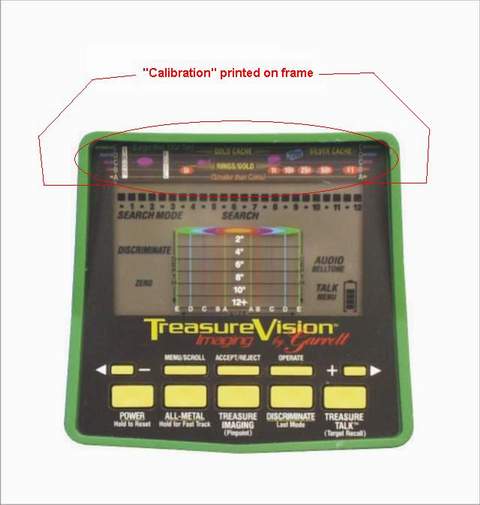

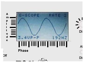

          Also front panel LCD frame part could be "calibrated" (divided and graphically ilustrated) for better understanding. For example at TGSL and simillar devices, origin TX phase can be printed on LCD frame (simillar to Garrett's LCD's) and later on LCD operater can follow phase shift at RX. Just an example.
          Originally i got this idea looking at Tinkerers shots. But this can be arranged anyhow. That's why i posted this idea here, to hear and collect more ideas...
            Just simple example....

              a scope view would be great. What is the bandwidth of the scope?
              Tinkerer
                Here an open project, very simple too :
                http://www.semifluid.com/?p=15
                  ivconic,
                  Tinkerer
                  It covers audio range as author stated. Should be enough for most of the projects we have here on forum.
