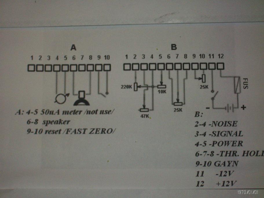

    i bought a kit for the Xr71 and got this diagram for wiring the pots.could someone please tell me how to make the connections to the B side of diagram?i dont understand these connections.this is my first that i hoped to learn from but now im at a standstill.thank you for your help
    Do you understand the symbols????
    At schematic, the arrows at potentiometers are the middle terminal. For example at the left potentiometer, you will take a wire from the left terminal of the 220K potentiometer and you will connect it to the pin 2 of the B connector on the board. After it, connect a wire from the middle terminal of the 220k potentiometer (arrow) to the 4 pin of the B connector ...etc......

      thank you i've gotten it all soldered up except for the headphone jack.do you wire it along with the speaker?
        Hi.
        The headphone jack must be at the front side, and the speaker at every place that there is free space.
          Ohhh.. and something else...
          When you turn on it for first time, turn all potentiometers to middle position.
