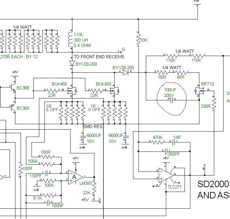

    Hi All,
    I was checking the diagram for SD2000 and they use a large value capacitor (100uF/200V) connected via a diode to the hot end of the coil.
    Does anybody understand the advantages of using this capacitor?
    So far. I've seen this capacitor only on Minelab boards.
    Nicolae
    Hi Nicolae,
    That capacitor is used to buffer the flyback voltage. You will notice if you hooked up a scope that when you turn the detector on, the peak flyback voltage slowly climbs to 180v over about 5 seconds. A smaller cap the voltage would peak faster. I guess that size is used so it can absorb excess energy if something were to go wrong.
    The irf710 is used to clip the flyback to 180v and the tlc271 drives it. Adjusting the values of the 2 110k resistors changes the flyback voltage level.

      Thank you Mechanic for your explanation, it makes sense. I think the capacitor + IRF710 is added as a limiting circuit to protect the MOSFETS BUK455. In case the coil would generate a voltage over the limit of the transistors BUK455, they can prevent it. This could be necessary because people try to use all kinds of coils, without doing any measurements.
      I had a look and I found BUK455 has a maximum voltage Vds of either 100V or 200V (two different types). They must be using the ones up to 200V, and the limit of 180V you mentioned seems likely.
      Based on this, it could be unsafe to change the resistors of 110K.

        Hi ... IMHO the cap is acting as part of a snubber cct. Read all about snubbers on google ... too much to drop here. :-)
          Hi Paul,
          Thanks for your feedback. I read about the snubber circuit on wikipedia and I think that circuit bears a close resemblance to the circuit from SD2000. Esentially the role of both circuits is to protect the controlling device. But while the snubber circuit in that image (Wikipedia) doesn't mind at all if the spike is completely killed, in SD2000 they want to control (= stabilize) the level of the spikes to a level as high as possible, but still under the maximum ratings of the mos-fets. It works in a pretty smart way. As long as the DC voltage on the cap can be maintained to let's say 180V, it is guaranteed that the pulses level will be in the upper vicinity of 180V. And it is much easier to control a DC level than the level of a pulse. Perhaps the circuit from Minelab can also be called a snubber circuit.

                    Hi Mechanic,
                    To me the SC2000 is still able to save energy (see my comment to Moodz). We both agree that IRF 710 has a regulating role.
                    Now, when you say "if IRF710 fails", the detector is unstable and jittery.
                    There can be all kind of faults with a mos-fet. If we would remove the BYV28-200 diode, that would disconnect the whole regulating circuit.
                    Depending on the width of the Tx pulse, the back EMF can reach (and most likely will reach in this case) the max voltage for the MOS-FETS (BUK 455), which may cause them to get warm (actually one of them more than the other). My guess is that the avalanche voltage for a transistor, will act as a zener diode and I don't see why the detector would be unstable and jittery (assuming the temperature for the BUK455 won't be too high).
                    As far as I know, any particular MOSFET, rated for example 200V will have a specific avalanche point (a constant voltage, pretty much like a zener diode), and the value of this voltage will differ from one transistor to another.

                      Hi Nicolae, Paul,
                      I'm still not convinced that the circuit is recycling power. It takes over the role of the avalanche function of the buk455. If this cct was not connected, the avalanche would still go to the batt- rail(-side of the 5600 caps.) as it does now through the irf710. But I could be wrong, this will puzzle me for a while!
                      When I said about the irf710 failing, I was referring to the pins breaking off at the base of the mosfet. This is a common problem because the mosfet is attached to the case, and has happened to me. I am unsure why this makes the detector become jittery, but probably does have something to do with the excess heat in the byv28-200 diode, hot buk455-200 and hot dampening resistors. The detection depths for small targets also seems to dramatically increase in air, but I have not tried in ground for a comparison. I think that also the sample timings would have to be changed a little too to be able to set the GB properly, as from memory last time it happened to me I ended up at the extremes of the GB pots in mild ground.
                      If the tlc271 fails, this causes the flyback voltage to be clipped at 12v and instead of lasting 4us(after 260us on time) the flyback lasts about 200us!

                        Hi Mick,
                        Now I am completely confused. I only realised now that the back EMF from the coil generates a positive voltage applied at the negative pin the 2 x 5600uF capacitors (via either the cap 100uF/200V or the avalanche of BUK455). This would only discharge the capacitors!? I must be drunk despite I haven't had any booz (today). Maybe I should drink something in order to think straight?
                        Anyway, if I got it right this time, it means you were right, the circuit only regulates the 180V and it doesn't save any energy.
