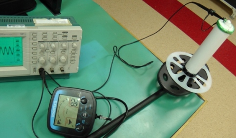

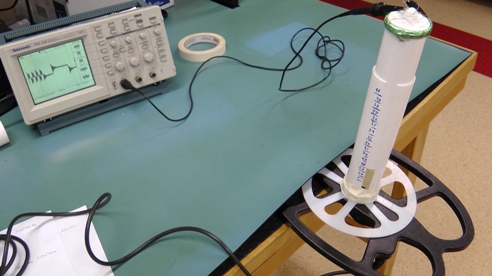

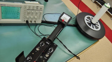

    Actually I use my test set made out of silicon tube and coil on the end made from 160 turns copper wire. the winding is 20 cm away from detector coil. The TX field is measured via oscilloscope Vpp but the RX sen. is estimated by adding variable pot as load to the winding. The higher resistance then better sensitivity. Works for me to check if getting better or worst.

        Being able to see a signal on a scope may not predictably translate to a beep on a coin in soil

        1) Size of pick up coil would have to relate to coil dia and shape being assessed.
        2) Coil turns would need altering for different frequency machines - to keep results between machines like for like..
