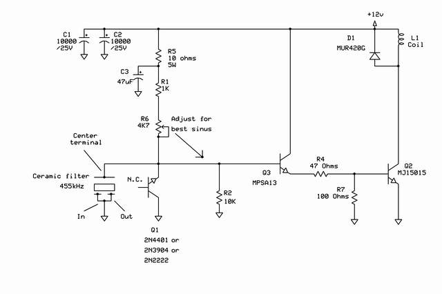

    I NEED TO TRANSMITER 455KH SINOS FREQUENCY WHIT HIGHT WATT AND GOOD Amplitude THAT OUT PUT LOOP(COIL) . Like TRANSMITER IN T/R LOCATOR.

    Ok...if you REALLY insist!
    Put Q2 on heatsink. Coil > 3 ohms. Use 12V / 4Ah least. 2N3904 is best choice for Q1.
    Enjoy!
      Enjoy!

      tank you ivconic
      please give me a few information abot this circuit .what is watt ?????
      what is coil???(best number wire and Tract for coil)????
      what Where connection beise q1???
      please Recommend like d1 and q2??????
      wait for you dear

        Originally posted by mesy64 View Post
        tank you ivconic
        wait for you dear
        tank you
        ~/<150W (depends of a coil features)
        Q2 possible substitutions: BUX11,BUX12,2N3773.....
        Q1 base NOT CONNECTED, don't worry, it is ok. It acts as special diode.
        MUR420G is 4A,200V ultrafast switching diode. Use any simillar.
        Coil is 1mH-1.2mH. According to given inductance you can make coil any shape and size you need. Limitation would be coil resistance. It should be 3> ohms.
        Do not ask me any more. I don't want to debate. You asked schematic and i gave it. Work - don't talk empty talks!
