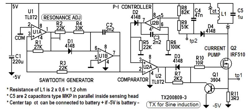

Peter,Originally posted by pebe View PostCan anyone point me to a circuit that uses a driven TX output stage - rather than a self-oscillating one?
Instead transistor type IRF510, can be used IRF540, IRF640, IRF740, IRF840.
Resistance of R11 is chosen so as to obtain a duty cycle about 0,2. It depends on TX coil resistance.
Resistance of R6 is selected so as to obtain a minimal settling time without overshot at test point tp2.
Adjust R2 for minimal duty cycle at test point tp1.Attached Files

Can you tell us more about the coil inductance and what range of frequencies this circuit works best at?

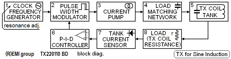

Why not "Sine induction"? Since there is "Pulse induction", must have antonym of that term. The design of the TXs and RXs are generally carried out in frequency domain. From this perspective, the metal detectors are of two types: Narrow Band MD and Wide Band MD. This is "TX for narrow band metal detector".
The maximum operating frequency of this circuit diagram depends on the operational amplifiers used. I experimented it at 6500Hz, but I think with TL072 and TL082 will work almost to 18KHz. The greatest need for speedy action is required by the comparator U2A, which acts as a pulse width modulator.
If you want your TX to work at a higher frequency, use for U2A an integrated circuit designed for comparator instead of one that is designed for operational amplifier.
If the term TWO BOX understand orthogonal coil configuration, no sense of this amplitude stabilizer because TX coil moves relatively far from the ground so that the parasitic modulation is weak. The circuit is suitable for sensors in which the TX coil is moving closer to the ground. Soil and salty water act as moving core. More on the issue of unwanted modulation of the TX, you can read my postings in section "Modifications".

The block diagram, which should be implemented for faultless operation of the TX for Sine induction, is the following:Attached Files
