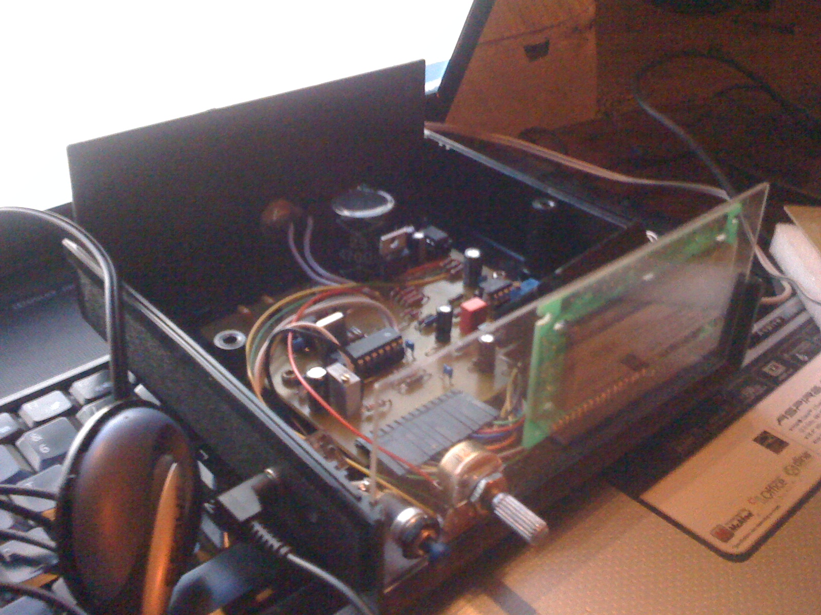

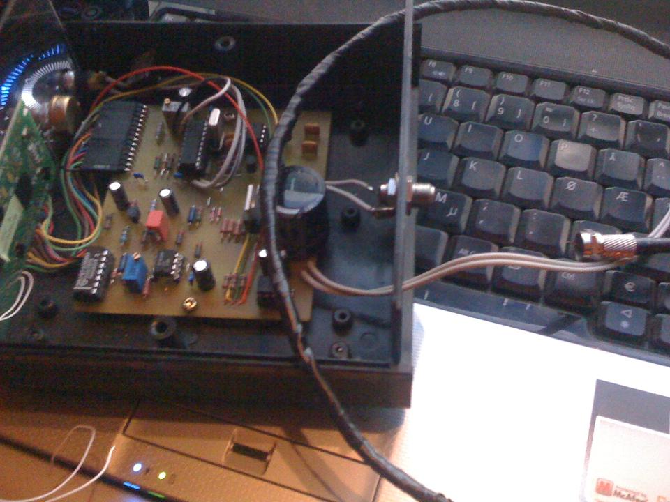

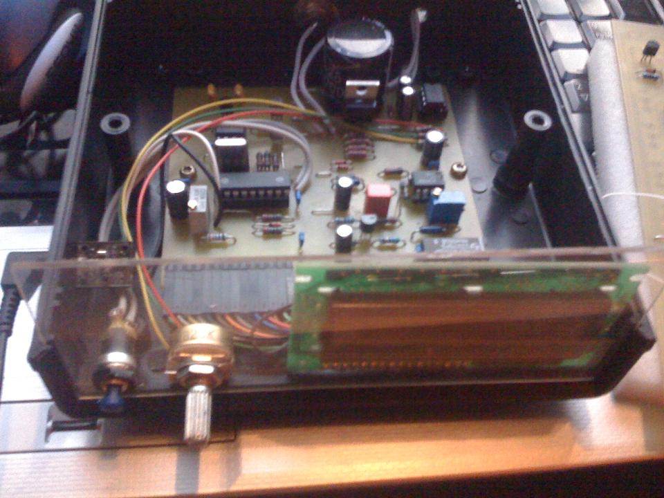

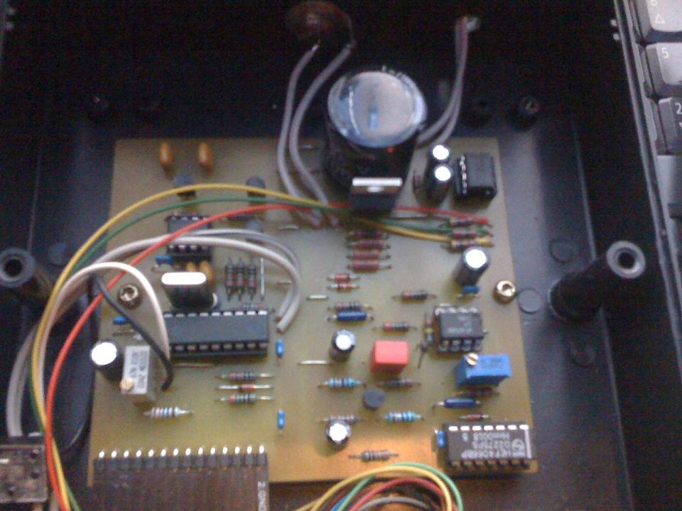

    this i have to say is a good detector for starters.
    easy to build and pcb can be buyed with preprogrammed chip
    its mighty sensitive and
    deep eaven with 4" coil
    25-30 cm on coins with 9"" coil
    1.2 m med 40mmx40mm square coil
    somone else have experince with it ?

    i had my goldpic 3 for 4-5 years ..testing all my mono coils on it
    i say it take pretty mutch from me ,,never had a error on it,,has always worked since i build it.
    other is gary pulse pi ..built 2 of them pulse 1 and 2
      please upload hex in topic

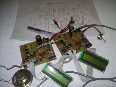

          Hi, I have built one of this kit years ago but never got finished. Micro and display work fine. I made changes to triggering transistor, bigger battery pack and supply circuit. I have started building low resistance coil (less than 1 R).
          I bought this kit to test the high power output driver. It looks like it will be possible to control max current for output transistor by varying duration of the triggering time. I know It is not practical to drive output with high current (due to battery usage) but I am looking for having that option under my switch. Do You have some experience in this matter?
