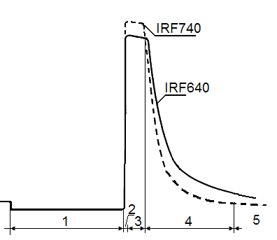

        The diagram below represents an experiment with different transistors. In intervals 2, 3 and 4 energy dissipates as heat in damping resistor, but in interval 3 energy dissipates also in the transistor. The instant power of dissipation in transistor is
        P = I x Vbr, where "I" is coil current. If you connect a diode with Vbr=200V in series of a MOSFET with Vbr=400V, then you have total Vbr=600V and energy dissipates faster.

          I do not believe that increasing the breakdown voltage is the purpose of adding a series diode. It does not happen.
            mts, mikebg,
            the matter of the Flyback voltage is only a part of the fundamental matter that you want to clarify. WHAT KICKS THE TARGET.
            If you search the forum, for "what kicks the target" you will find many, many posts. I don't think a consensus has been reached yet. It is a complex matter.
            The matter of the diode between the Mosfet and the coil is another such disputed matter. Ideally the diode should be of the same Vbr as the Mosfet. To be of any use, it needs to be an ultra fast switching diode.
            If the Mosfet is chosen to have a Vbr high enough so that there is no avalanche breakdown, it will probably have a high drain capacitance. This capacitance extends the delay to the point where the Flyback decay has reached a level close to 0V, that is the traditional first sampling point.
            An earlier sampling point means better sensitivity to smaller targets.
            The series diode isolates this high drain capacitance and thus makes the detector more sensitive.
            However, it is useless to use a 1N1007 or such kind of diode, that has a recovery time in the uS. The diode has to have a recovery time of a few nS to be of any use.
            When using the diode, the Mosfet should not avalanche.
            If you push the Flyback voltage to 1000V, you will have a faster decay, but you might also get insulation problems.
