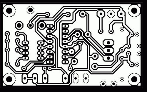

    You see this board
    It's a forum here
    There is a problem are you can identify exits 1 and 2 in the picture
    Party and No. 1 in the ic 8038 Is
    To v+ direct
    Where 1 and 2 to where???
    You all thanks
    The 8038 is a waveform/function generator chip. Point 1 you hook up to an 8 ohm speaker, and at point 2 are different waveforms that can also go to an lm386 or transistor buffer.
      This is a simple signal generator. The output signal (1) can be connected to whatever you want a signal for. The amp is connected to pin-2 which is a sine wave, but could be connected to pin-3 or pin-9 for a triangle or square wave. There are data sheets available on the 8038 that explain all this.
      - Carl

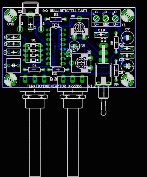

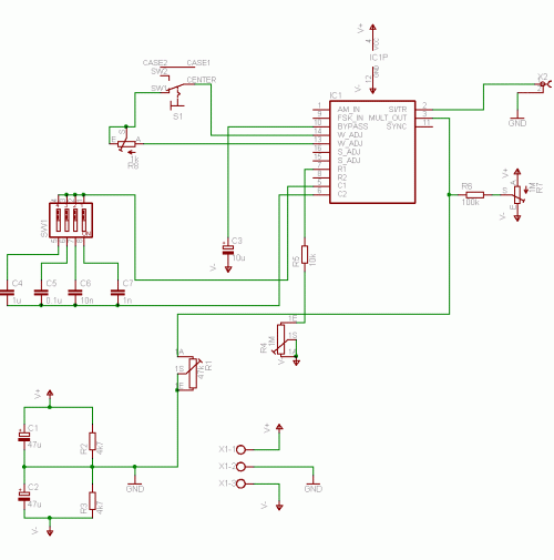

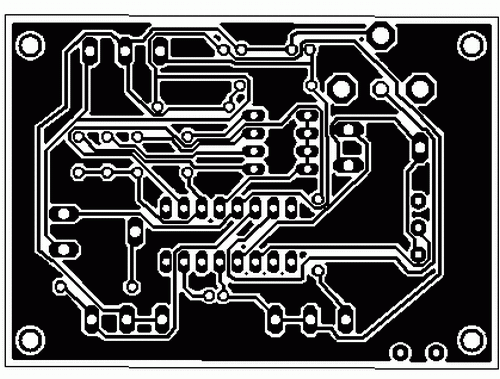

        Hi @alnamr,
        Why are you using an obsolete chip ICL8038 ?
        I have a few of them, but if I had to buy them now, then they would cost me $50 or more!
        Why not use the cheap $3 and better XR2206 from EXAR ?
        XR2206 from Mouser.com (Clock Generator 10V-26V 0.01Hz-1MHz Temp. 0C to 70C):
        http://nl.mouser.com/Search/Refine.aspx?Keyword=XR2206
        XR2206 Function Generator:
        http://www.solderingpoint.com/projec...206/xr2206.php
        XR2206 Function Generator (New Version):
        http://www.loetstelle.net/projekte/x.../xr2206neu.php
        Note:
        Elektor Electronics Magazine has many Function Generator designs using the XR2206 including the PCB's. Many of which can still be ordered (cheap), or made by yourself by the presented PCB Layouts.

        Robert
          hi mr carl
          Well 3 and 9 on the pin
          However, two out of 386
          Where to arrive
          To the pin as well? I see the image
            I don't understand your question.
              wherefore 3 and 9 pins of the IC use for? (if they are FREE, on the schematic)
              yours
                Thank you, Mr. Carl, and I apologize you have disturbed a lot
                Mr. kt.315 I'm connected to the ground sockets 3 and 9 and leave the C4 and aut Signal -emptyThat's right??
                Party Is No. 1 in 3083 is empty??
