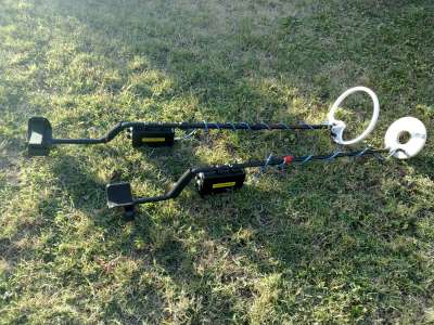

    Hi,New Pulsemate pulse induction metal detectors ,Found!
    for individual an club use,non commercial. custom made one offs!
    for bush an beach. Australian Made!
    regards Rov
    Hi ,a pair of Pulsmate detectors,
    regards Rov

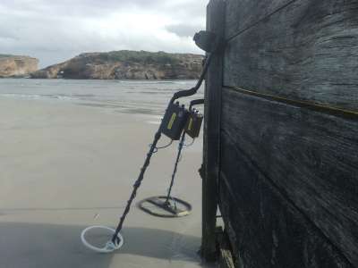

      A pair Pulsemate detectors at the beach.
      regards Rov

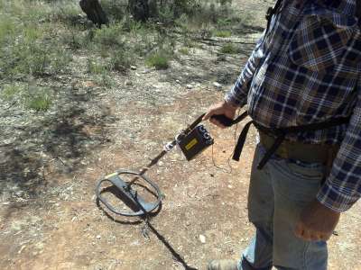

        Pulsemate Pi in the bush,with a 18x14 coil.
        Regards Rov

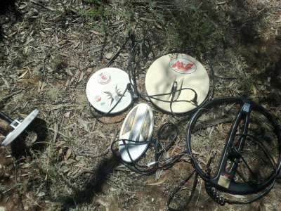

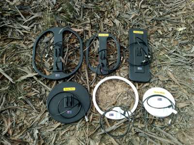

          A collection of coils,various sizes,tested an proven,in the ground!
          various config. monos etc. fig8 an screened ,unscreened to suit conditions.as used in the Pulsemate detectors..Special Thanks to Bill Hays for all coil housings used,for detecting enthusiasts. at Hays Electronics. USA

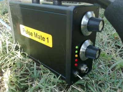

                Hi,twin main control pots offer tone/threshold an frequ.balance control
                Ground balancing is rudimentary via this control an coil matching with the ground conditions.most coils in the range have shielding.some are fig8 anti interference wound for tough ground an emi rejection.
                the main detector unit is of course a Pi,based on several designs an features microcontroller.Design of the schematics an proofing/layouts,prototyping manufacture of custom pcb was done thru Sesame Electronics,here in Australia.Towards one year of development was put in by Neville Hoffman an his team towards this.from Sesame.
                Good work Neville!
                the PI unit can run 2 types of microcontroller programmed chips,one with programmed in conservative timings an delay.another with faster timing an delays for tougher conditions an more refined nugget hunting use in the bush.These Micros are done by another small developer group. These are plug in an swapable between uses,but not on the fly! the Code is locked on these an non operator reprogrammable.
                Descrimination is only via the db cutoff for the Led signal level meter for metal targets only.ferrous an non ferrous display differently via the Led Signal meter,an judgement by the operator is still require to visually interpret this unfortunatetly.
                unit has its own inbuilt speaker/piezo transducer.an 1/4 inch headphones jack.
                several units have been made that feature inbuilt twin 9v mHi rechargeable batteries an a dc socket. twin supplies are required 2x9v one for drive electronics another for audio stage an Led signal level.
                To date over a year of field use has been achieved in various conditions from the wet sands of beaches for coin an jewelry hunting etc to park and paddock use for relic hunting an coins,to pure bush gold nugget hunting.

                    Best to say the performance is dependant on soil conditions,Test item,an how it is buried ,size an item type ferrous or non ferrous.the type an size of coil used determine greatly also the performance. with 8 inch mono unshielded, sensitivity is more significant with ability to detect BB lead shot within several inches.for large 18x14inch elliptical style this same lead BB shot is not detectable under any circumstance unless almost rubbed across face of coil.is is to be expected! This is similar to a wide range of commercial produced PI detectors.
                    By the way this Pulsemate PI will run a host of commercially manufactured coils easily via a simple 4pin to 5 pin adapter lead.

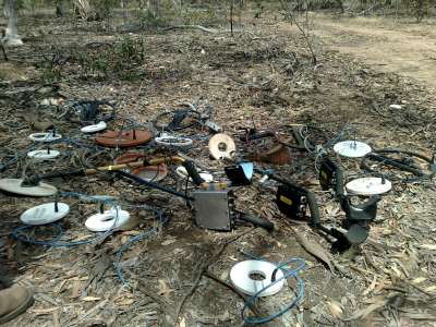

                    Tested to date have been Minelab commander in DD an mono 8 ,11 an 15inches,Coiltek 14inch elipticals,Coiltek18 mono.even a Garretts Infininium eliptical with a full plug replacement of course.also several C Scope PI coils. For your interest.
                    All with their differences in depth,sensitivity an Character when used,on the pulsemate machine.But they work,so the versitility is very functional an usefull ,for a wide variety of field use.

                      A Few assortment of coils used for testing in the field.
                        And some more,in the field.
