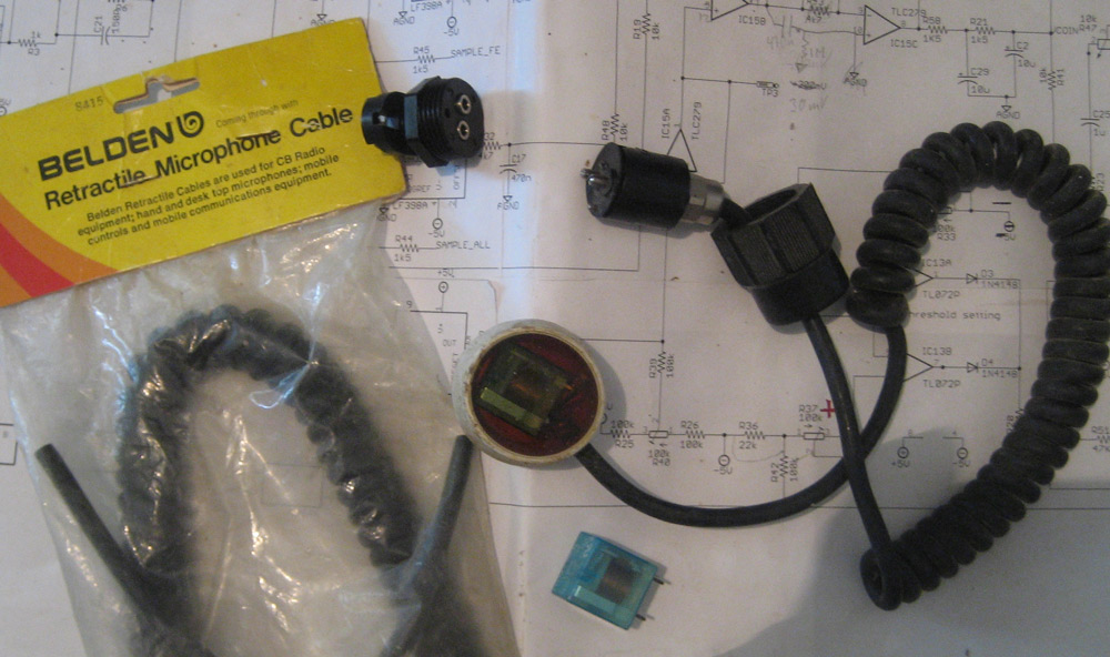

            I still got some around, including the spare parts, need to dig them up. They are simple to build. The clicker is a relay, cast in epoxy resin. It needs a diode to quench the flyback from the relay. I used a red LED, so it made a visual indicator at the same time.
            Give me a day or two to dig up all the information.
            Tinkerer

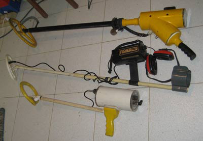

                  Attached are 3 pictures.
                  #1 shows 3 Underwater metal detectors. The top and bottom one use click bone conductors. The middle one uses a piezo element.
                  # 2 shows the parts. the bone conductor element is the relay. The clock is produced by the relay switching. Only the switching pins, the solenoid, are used.

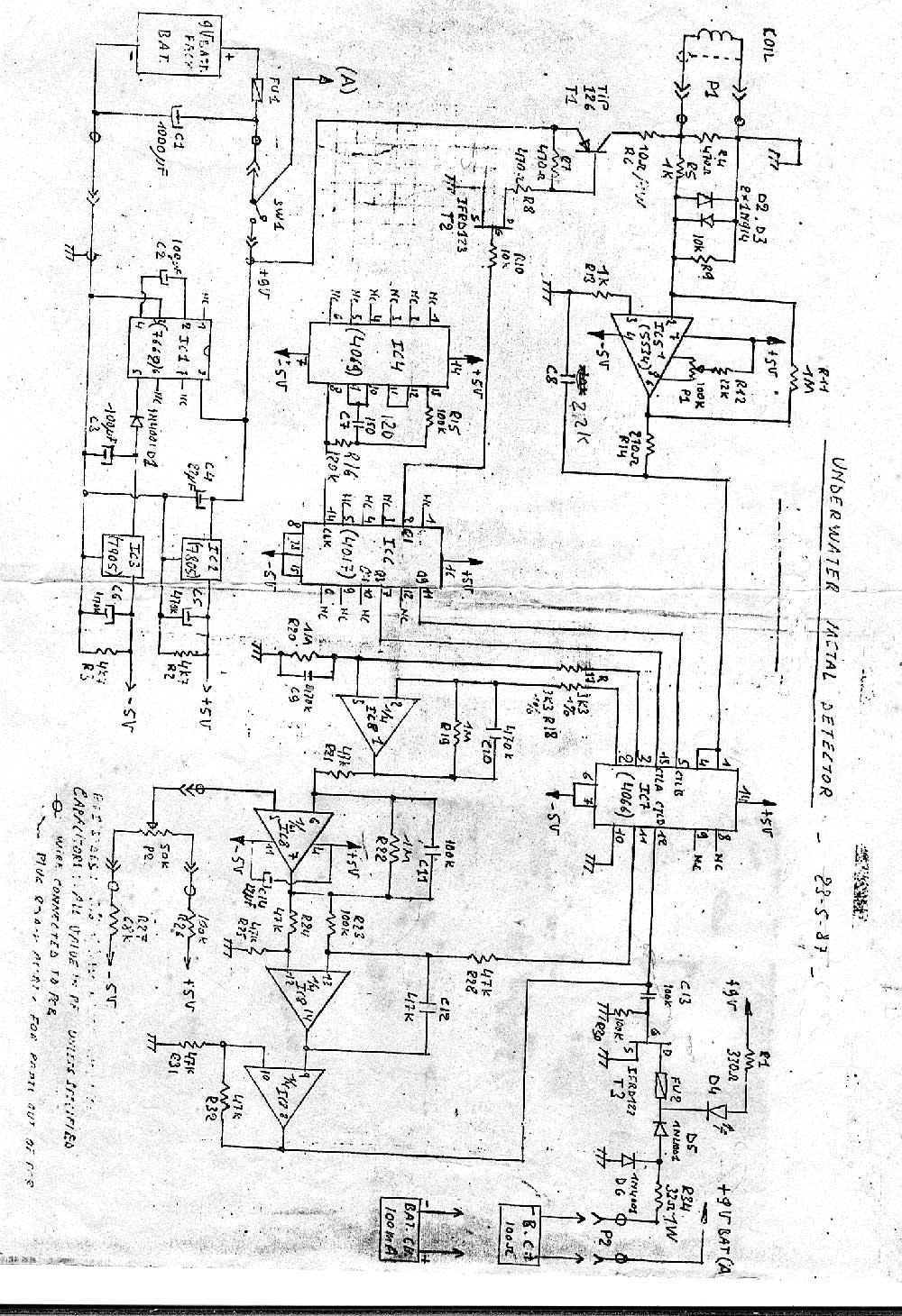

                  # 3 shows the schematic of the bottom detector. Note the output of the bone connector is also the input of the NI-Cad batteries charger.

                    A nice, simple setup Tinkerer. I like it!
                    What brand of waterproof connector is that? Did they work well?
                      These are IKELITE waterproof connectors. I don't know if they are still in business.
                      I never had problems with the connectors, but they only have 2 pins.
                      I still have a bunch of connectors, actuators and housings for metal detectors like the bottom one shown.
                      They were made to go 200 feet deep.
                      I used to stick the bone connector under my diving hood, anywhere near the ear or under the mask strap for just a quick dive.
                      Tinkerer

                          interesting
                          whats with C8 being 22k
                          I take it really should be an R
                            interesting
                            6666,
                            this was my first try in metal detector design. The date is on the drawing 23 of May 1987.
                            It was working well, but strictly for diver use.
                            C8, 2.2KpF is part of the low pass filter together with R 14.
                            Tinkerer
