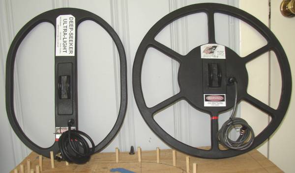

      that is why I have 5 Whites detectors, the Whites TDI is my favorite. I love Whites detectors so much that I build my on coils for the TDI. lamarc

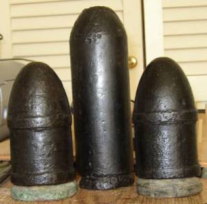

        OH I failed to mention the relics found with the Whites
        TDI an my custom made coils . These artillery were shallow at the depth of 3-1/2 FEET DEEEEEEEEP. lamarc

          Did you had the GB=On or off
            OFF
            I had the GB off
              Nice coils. Are those coil housings from Hays Electronics?

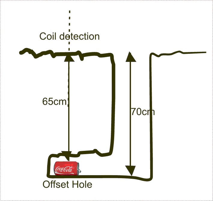

                          Hello Forum and Vourvon,
                          You must know for a good testing is not like that..... you have two method
                          1) you dig your hole put the metal inside and close the hole again ...BUT you must wait sometimes before the checking ( 1 month minimum) to have a COMPACT SOIL like in the REALITY.!!!!........o
                          2) you dig a hole and make a insert hole to have vertically a COMPACT soil for the testing ....see my draw...
                          It is really to easy for your presentation to see your target with your " FRESH HOLE" and worse with the VLF detection of the Golden...
                          Alexis
