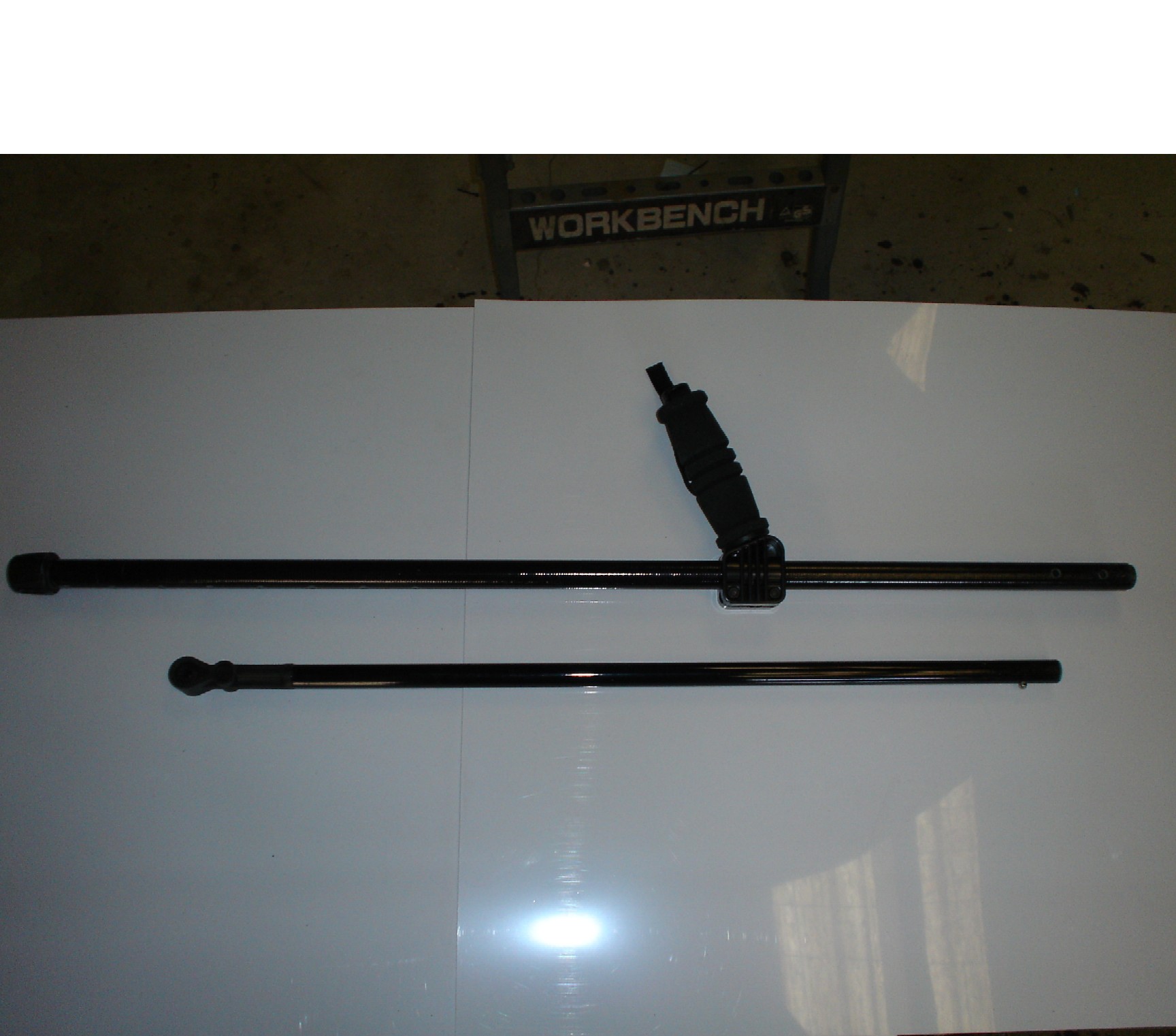

      i made this shaft for my minelab soverign xs from a hospital cruche and a mountain bike handle bar end for the hand grip.
        Good job!
        The middle shaft not wobbling?

            I build my straight shaft.
            Thanks again, to you guys for all the pics and suggestions
            VERY nice work.....congratulations!

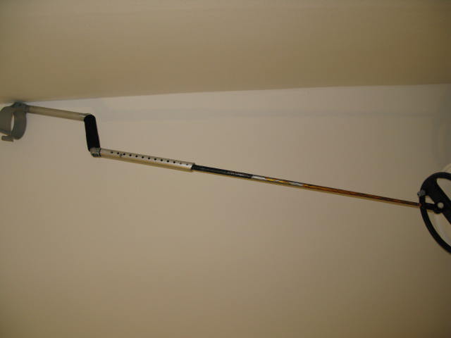

                        I cut the crutch and reassembled as in photo with the step in it, I used aluminium solder to braze with gas lamp.
                        The sponge grip is cut to length scooter grip from Halfords
                        I used a stiff flex graphite golf shaft epoxied to cut down crutch.. I whipped some kevlar thread on the outside to freshen the response. Arc over the ground is 7ft dia.
                        It is very light.
