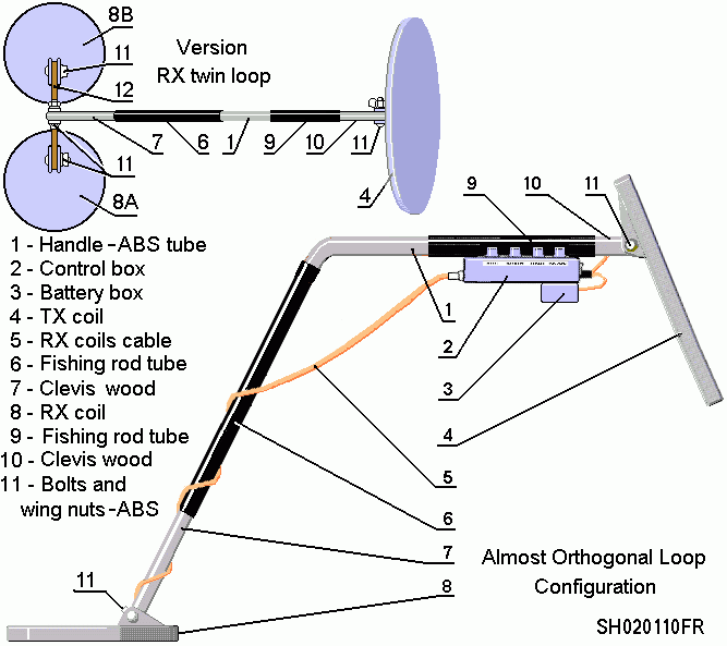

              For your purpose (sensitivity to deep buried beer cans :-) you should use orthogonal coil configuration, known as TWO BOX. Reinventing this coil configuration, the (R)EMI group modifyed it in order the RX coil to be moved close and parallel to ground. It was renamed as "almost orthogonal" coil configuration because induction balance in this case is achieved at near to orthogonal coil placement.

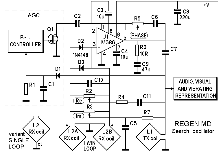

                SEARCH OSCILLATOR
                This is the circuit of "powerful and sensitive" search oscillator. To detect deep large targets, should be used
                large center tapped RX coil (shown in lower left corner) instead TWIN LOOP L2A and L2B.
                The sensing circuit consists of an audio frequency amplifier using "powerful" AF IC as LM386 or LM388 loaded with 4 ohm TX coil. Unlike
                conventional circuit diagram used in HOUNDOG, additional components (Q1, C2, C3) are connected to obtain
                gain more than 40dB. The phase characteristic of AF amplifier is controlled by potentiometer R5.
                The swing of output signal in pin 5 is maintained below saturation points by automatic gain control (AGC)
                circuit. The AGC consists of amplitude detector (D1, C1, R1), P.-I. (proportional - integrating) controller and
                voltage controlled resistance (Q1). Two voltages with different phase are used for bridge balance. The phase
                difference between them is set near to quadrature (90 deg) by capacitors C5 and C11.

                  The reinvented circuit was renamed by (R)EMI group in IBR - Induction Balanced Regenerator. As a regen radio it can operate in 3 modes:
                  1. The IBR always oscillates like search oscillator in a classic BFO metal detector. If there is a target, the oscillating frequency changes. We can use a second (reference or BFO) oscillator and mixer to display as audio signal the frequency shift.
                  2. The IBR circuit oscillates without target. The target signal acts degenerative and compensates regenerative (positive) feedback signal from TX coil to RX coil; oscillation die out. This method is like absorbing principle used in small pinpointers.
                  3. The circuit not oscillates without target. Transfer impedance of target closes the balanced feedback path and if the Barkhausen's criteria is satisfyed, oscillation starts. The oscillating frequency depends on phase characteristic (phase - frequency response) of target. That means we can achieve good target identification if we design properly phase characteristic of amplifier. The AGC is neded for this method to maintain the very high gain at threshold of oscillation. Since this is the preferable method of operation, it needs comprehensive explanation.
                  The positions of RX and TX coils are adjustable to set induction balance. Additional bridge balance is adjusted fine by potentiometers "Re" and "Im". At theoretical ideal balance, the feedback path is disconnected (signal AIR is zeroed). Since amplifier has extremely high gain, it so amplifyes noise, that the output should be saturated by noise voltage without AGC as shown in figure A of attached oscillogrames. The AGC reduces so the gain, that output noise voltage in pin 5 has swing Vref below saturation swing Vsat of IC as shown in figure B.
                  Note that at ideal balance, the noise gain of circuit is not increased by regeneration because in theory there is no regeneration. Unfortunately the GND signal is not zeroed despite there is second RX coil (TWIN LOOP configuration) for ground and interference balancing. In practice the AIR signal also is not ideal balanced.

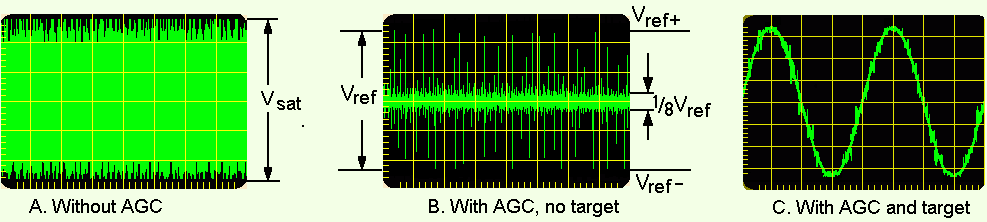

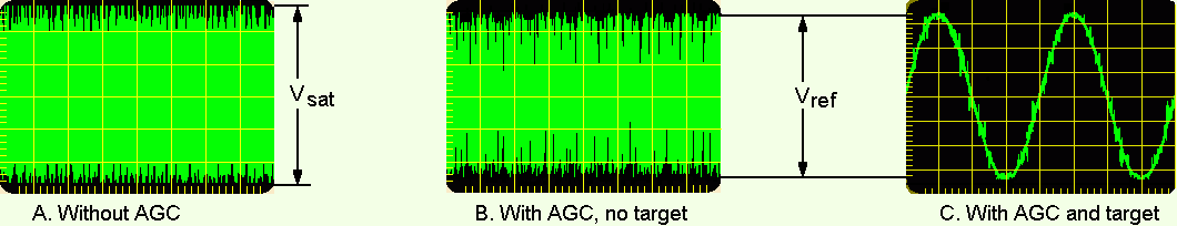

                  When there is a target, it closes the feedback path. If the feedback via target is positive, the swing of output noise starts to increase, but the AGC reduces gain. As result, target signal diminishes noises in output of amplifier and appears sinusoidal signal having a dominating frequency at which phase shift in regenerative loop is 360 deg. The frequency depends on phase characteristic of target. This is shown in figure C.

                    To reduce GND and interference signals is used coil configuration TWIN LOOP for RX coils as shown in the circuit diagram. The TX coil can be placed in coplanar or in orthogonal (TWO BOX) position for induction balance. However, the TWIN LOOP is not suitable for large RX coils.
                    For deep buried large targets (like golden skulls in depth 2 metres:-) is preferable the orthogonal coil configuration like Depth Multiplier of Garrett, but for best results, the RX coil(s) should be moved close and parallel to ground. At this position, the TX coil should be adjusted in induction balance at "almost orthogonal" position as shown in the attached figure.

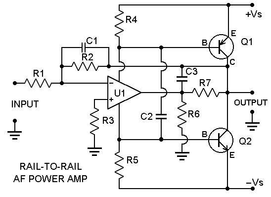

                        If the principle proves successful, you must upgrade the amplifier because the shown circuit with LM386 is not enough energy effective. For example, at 9V supply voltage and load 4 ohm, the output swing is just 3,5 Vpp instead 9Vpp in ideal case. If you upgrade the circuit to achieve 7Vpp output, the search oscillator will be 4 times more powerfull. I saw in the site of Gary Chemelec used the principle for the implementation of rail-to-rail amplifier by adding a pair of complementary transistors, but I'm not sure that the principle would work stabile with LM386 at voltage gain 60dB. The principle of upgrading seems so:
                          Correction of oscillogram B in posting #9.
                          Reference limits Vref+ and Vref- are not represented in the figure B of posting #9. When o-scope is scaled so that limits are visible on the screen, noise seems as a strip having width about 1/8 of distance between limits maintained by AGC. This distance is noted as Vref in the attached below figure. Remember this picture. It shows that AGC operates and limits gain so, that output of amplifier is not saturated by noise. The width of noise strip can not be measured correctly. The visual effect is between 1/6 and 1/8.
