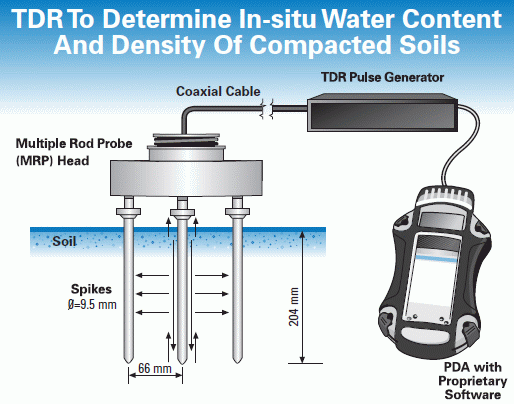

    Does anybody know, or have used, the "Moisture+Density Indicator" from "Durham Geo Slope Indicator"?
    Do the non nuclear methods for in-situ density and moisture determination, really work? Is this a proven technology?
    Any thoughts?
    Principle of operation
    Principle of Operation:
    Time Domain Reflectometry (TDR) is used to measure
    the travel time of an electromagnetic step pulse produced
    by the TDR pulse generator through four soil spikes in the
    ground. The voltage signal is analyzed by a PDA running
    specially developed algorithms to determine apparent dielectric
    constant and bulk electrical conductivity of the soil.
    The software uses a set of equations to relate these two
    properties to water content and density which are displayed
    on the screen.
    Two field testing methods (described in further details on
    page 3) meet ASTM Standard D 6780:
    • A One-Step Method—the usual method—which is simpler
    and quicker in the field than the Two-Step Method.
    • A Two-Step Method which is used when immediate and
    approximate results are desired, without waiting for compaction
    tests, or when salinity is a concern.
    Note: For applying either Method, soil tests in the laboratory
    are recommended for the purpose of obtaining soil-specific
    constants. However, reasonable test results may be
    obtained with assigned values and further refined subsequently
    with laboratory tests.
