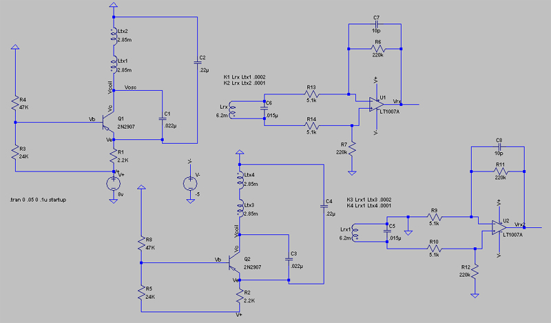

    Here is a crufty LTSpice sim probably showing nothing realistic, but spurrred on by dfbowers question about a spice simulation showing a grounded vs. ungrounded RX coil.
    In the picture, Vc is the TX oscillator signal for reference (I forgot to name it smartly).

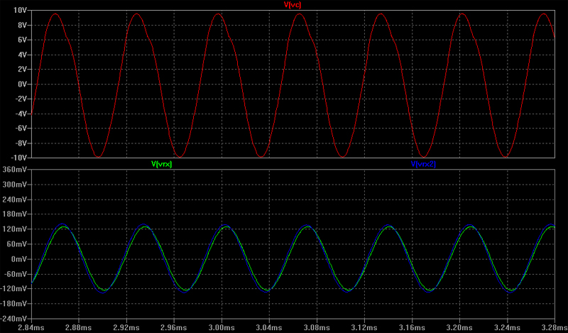

    The simulation seems not to show much difference at the output of the op amp which stands in for the LF353 (Vrx1, Vrx2).
    The simulation looks more complicated than it is because there are two identical TGSL front ends not connected. One has the RX coil lead grounded as we do.
    To model the null, I divided the TX coil into two parts, and mutually linked each part to the RX coil with a small mutual inductance. The two coils are linked to the RX coil with opposite polarity, so they fight each other. If the mutual inductances are the same, no signal appears from the RX coil. By making one mutual inductance slightly bigger, I can make a null signal of either polarity I choose.
    I have not modeled the phenomenon that causes the null signal to gradually shift phase from one polarity to the other, so I'm not pretending it is a realistic simulation.
    There is no modeling of shields or EMI noise, target, etc. Just the null signal.
    Anyway, there it is.
    -SB

    Excellent.. Thank you Simon. After making 3 coils that could not handle the wet grass wired with a grounded Rx, I was motivated to make an ungrounded one, which completely solved the wet grass problems. I will most probably make subsequent coils ungrounded just because of that.
    I was mostly looking for unseen issues that an unground coil could cause but so far, I just don't see any. I would like to see if we could get an explaination from some of the more seasoned members on the forum on why a grounded Rx circuit would be more preferable.

        (Of course take that sim with a big grain of salt... no physics to speak of.)

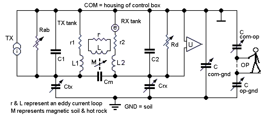

          SPICE can't help to solve problem.
          Ungrounded RX coil needs symmetry of front end circuitry. Another solution is to ground center tap of RX coil.
          The task of shielding is to suppress the influence of variable capacitances shown in the attached equivalent circuit. Although SPICE can simulate variable capacitances, no benefit from this, because it can not show to the designer how and what must be shielded.
          The equivalent circuit is valid for non symmetrical grounding of the TX and RX tank circuit. However, in electronics often used symmetry to avoid shielding. The easiest way for symmetry is to use center tapped coils and connecting the center tap to COM rail.
