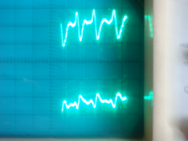

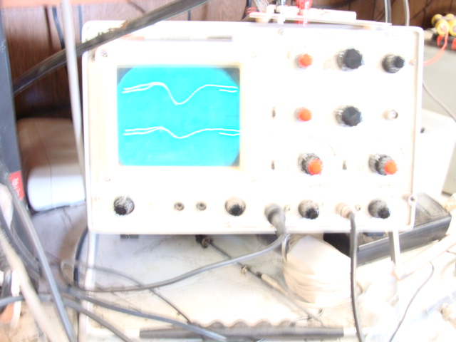

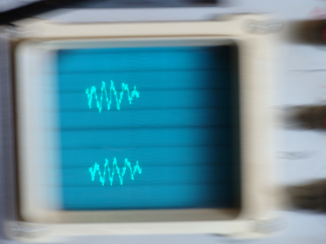

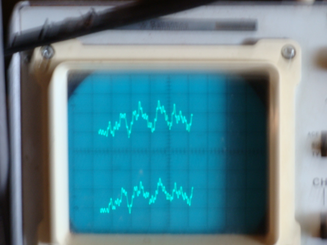

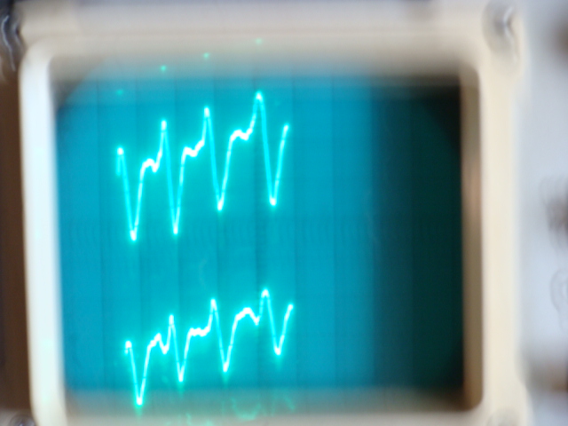

                        Well I made an attempt at doing the ferrite test this afternoon. I slowed the sweep way down on the scope and took about 1 second exposures. I had to play with it quite a bit to get anything but I saw several interesting things.
                        In all cases the GB channel is the lower trace. I did take some both inside and outside of null, but I did not know what the frame number was so will have to repeat that part of the test.
                        I post the pictures to see if this is even close to what you are looking for.
                        Jerry

                          Hey, very good! I see something I was looking for. Third photo, GB channel trace looks kind of inverted. I was expecting the GB channel on one side of null to look inverted to other side.
                          Are the last two photos for a metal target?
                          Really appreciate it. Excellent work. No way could I get that kind of consistency.
                          I'm trying to formulate an opinion about which side of null is preferable to null coils to, and why. I'm sure many people have opinions, would like to hear their reasoning.
                          -SB

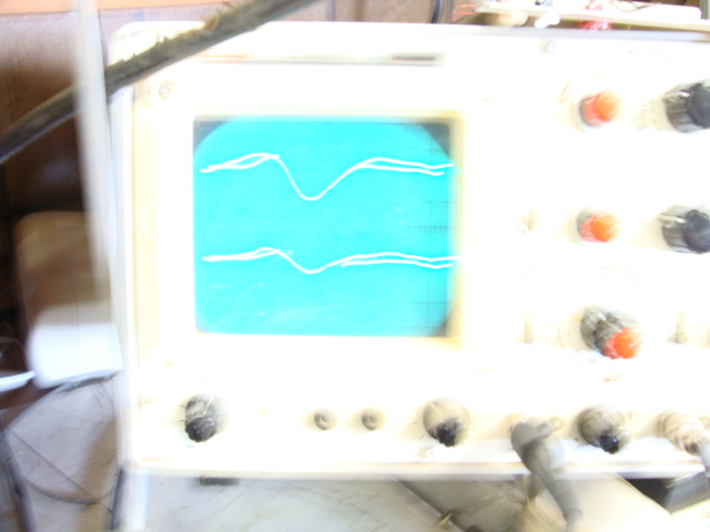

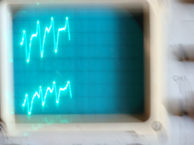

                            Hi Simon:
                            The last two photo's were with a different scope sweep speed. I actually took those before the others. I slowed down a lot for the first three and probably should have left the last two out of my report.
                            I need to get better at recording stuff as I do it.
                            Here are two more pictures that have nothing to do with the test but are still interesting. Scope is connected as before but I shorted out the input terminals on J2. The pictures are a time delay of the circuit noise. I need to do this again and sort out the various frequencies shown.
                            It is too bad I cannot see this in real time. These pictures are using a pretty slow shutter speed. All you see on the scope visually is a dot jumping up and down as it sweeps from left to right. I will do this again tomorrow and write down all the settings for camera and scope.
                            Jerry

                              That's interesting. I'd like to know what the approx noise voltage is with RX coil shorted at the PCB (you need very small jumper to short, otherwise, antenna).
                              Also relevant is where the DISC and GB pots are set, just for interpreting phase of signals.
                              It also is useful to make the two traces a little closer together vertically to compare phase.
                              It might be interesting to ground the non-inverting inputs of the LM358 chips to see how much noise contributed by the main filter section. I would expect very little noise at output of LM308.
                              I'm curious also about observations of noise at output of LM308 if the input pins of the LF358 are shorted with very small jumper, compared to shorting the RX coil. In other words, how much noise comes from the path from the RX coil entry point to the PCB to the LF358?
                              -SB
