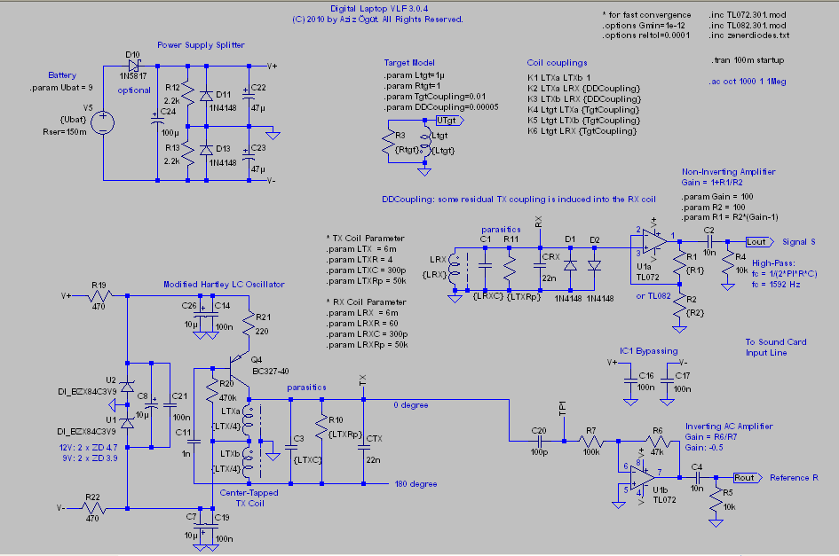

        Wiring Finished
        Hi all,
        the test board is almost finished. The LC oscillator is running and observed at oscilloscope: perfect (low distortion) sine waves at 28 Vpp between coil ends. I did not have all the parts so I have taken similar parts.
        Total power consumption: max. 12 mA (at 13.8 V input)
        TX reference output: 1 Vp (2 Vpp)
        The rest will be tested soon.
        Aziz

            Schematics Changed Slightly
            Hi all,
            now the new board is more tested. But I am not happy with the hardware phase shifter at all. The phase shifting pot (GB pot) is changing the input impedance slightly and this changes the reference TX signal amplitude at the output slightly. Something I wouldn't want to have it. Otherwise, I have to reduce the TX oscillator signal output impedance, which is not good to increase the load of the LC oscillator for stability issue.
            So let's get rid of the hardware phase shifter totally. Let's mod it.
            I will replace it with a simple inverting amplifier, which also reduces the high input voltage of the TX coil (capacitive voltage divider gone, input impedance increased, gain < 1). The phase shifting (GB setting) will be done purely digital in the software.

                      Promissed Spice Files and Schematics
                      Hi all,
                      this is the current version of the purely digital version of a VLF hardware implementation using a sound card and laptop (netbook). The software is not included (hell, it's still an experimental code and even not finished yet).
                      Small changes in the RX amplifier gain and reference gain should be done to meet the sound card input specification.
                      With the new Netbook computers and a 9V battery block for the circuit (drains < 10 mA), an one-day-detecting should be easily possible (using the internal sound card of the computer only).
                      The software should implement a complex digital lock-in amplifier, which extracts from the input signals phase and amplitude relationship of TX/RX coil configuration. Furthermore ground effects, which also affect the TX voltage, should be taken into account (information is there and is detectable).

                            Just some comments:
                            If the sound card is not capable of sampling at 96 kHz, the oscillator frequency should be lowered increasing either the coil inductivity or the resonant tank capacitors (CRX/CTX). If possible, a 24 bit sound card should be used. But it should run with 48 kHz/16 bit sound cards as well (reduced performance).
                            Now all what you need is the software and the coil + active circuit board shown above.
                            Aziz

                              Hi Aziz,
                              sorry if I miss something.
                              Soundcard usually have one signal input (Line In). You lead two signalls ("Lout" Signal S and "Rout" Reference R) to soundcard Line Input.
                              Presume that those Line In have to be stereo?
                              So "Lout" and "Rout" mean left and right channel of Line In?
                              How important is corect connection in other words: can both channell be exchanged by each other or not?
