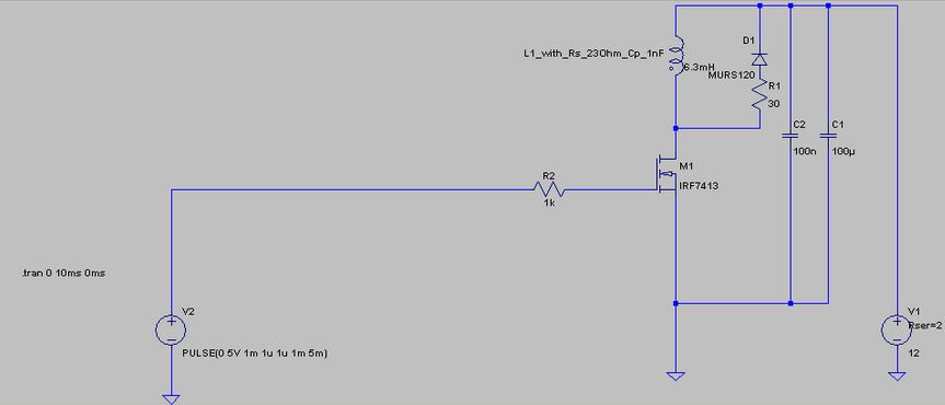

    Actually, the received signal is parallel connected to a 1k resistor.So, that's the parallel signal from the resistor and the coil?!
    And yes, I expected to see a chance in the amplitude?!?! But there is nothing as long as the metal is not in the "crossing section" of the coils...

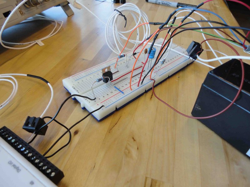

    Oh, before I forget: The shielding of the coils. I put both shielding wires together (as you can see on the picture) but if I connect the shield
    with any GND, the signal is clear away....
    Did you leave a break in the shielding? If you did not it will act as a shorted turn and kill the received signal. Also the shields on the two coils must be insulated from each other where they cross over.
      Okay, but I can deinfitely put both shields together and connect it with one GND?

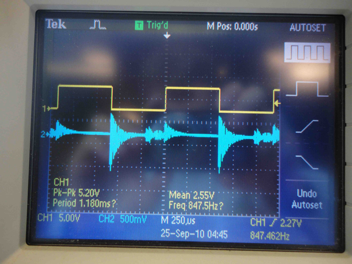

        Okay... I got some new data again.
        I already optimized the coil and enhanced the circuitry... But the reuslt isn't really good....
        Here is some data:
        Tx:
        Frequency: 847.4 Hz
        Period: 1.18ms
        Mean: 2.56V
        Pk-Pk: 5 V
        Coil resistance: 22.3 Ohm
        Inductance: 6.3 mH
        Rx:
        Frequency: 63 kHz
        Period: 13 us
        Mean: 20 mV
        Pk-Pk: 1.2 V
        Coil resistance: 24.4 Ohm
        Inductance: 6.5 mH
        Please see the attached pic. I don't really know why the received signal is oscillating... I also put a 100k resistor parallel to the rx-coil...
        Best, Simon

              If you are trying to build a PI detector, which I assume is the case, your inductance values are far too high. Please read the Hammerhead article in the Projects section. Try using around 26 turns of wire to get an inductance about 500uH. The actual value is not really critical.
              The ringing is happening because you do not have a damping resistor across the coil. Again, look at the HH article for details. 690 ohms is a good value to use as a starting point, and don't forget the limiting diodes.

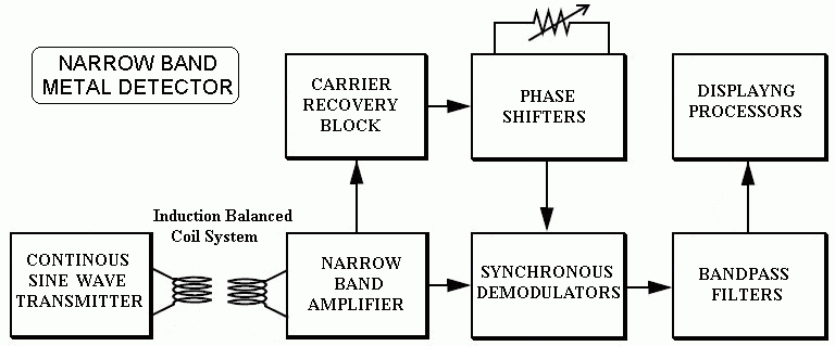

                          Originally posted by SIMONN View Post
                          To be honest, I don't understand how to use the signals. Therefore I need assistance, please. Does somebody have experience with data evaluation?Another question:
                          - Can I already use the signal (if phase difference is available) to discriminate between different metals?
                          Additionally, I'd like to digitize the whole process via DAQ.
                          SIMONN, the block diagram for narrow band metal detector in posting #23 is too primitive. It can not achieve deep detecting because not uses real GND signal for synchronous demodulation. The GND signal is artificial. It is produced from voltage across TX coil.
                          The attached block diagram is better but not the best.
                          Best principle for narrow band metal detecting is described in patent US 3,614,600.
                          The principle of wide band metal detecting with DSP is described in patent US 4,506,255.
